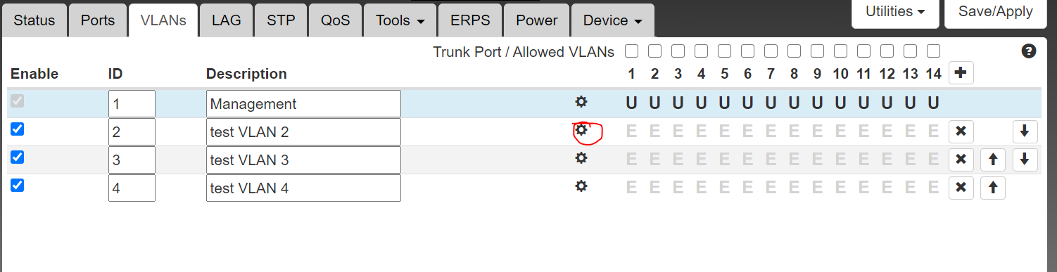

In the VLAN tab, click the gear for the VLAN you want to assign an IP address to.
You can assign an IP address to VLANs there.
This won't work for the Management VLAN because it already uses the IP address of the switch.

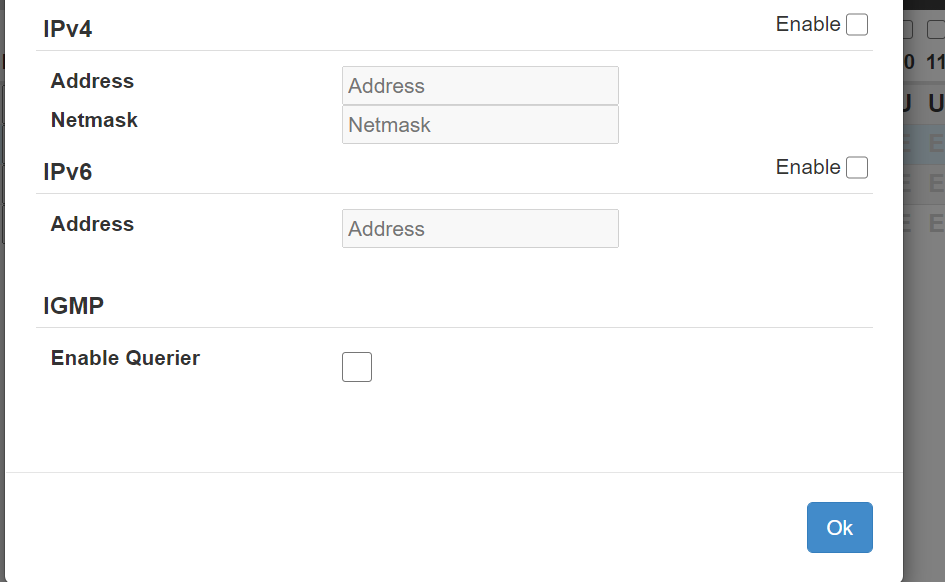

Re: Multiple Ip addresses
When you go there, it says "Note: This IP address is only used for Watchdogs and is non-routable"; I'm actually trying to move management of the switch onto our management vlan... A hack would be to bring the untagged packets into the management vlan on the uplink switch, but that's a hack...

The message "This IP address is only used for Watchdogs and is non-routable" is a little misleading. Those addresses can be used for management if you are directly connected on the same subnet. If you are not on the same subnet, it will accept connections on those addresses if traffic is routed to them, and will attempt to send the response through the default gateway in the main configuration.
