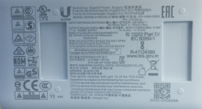

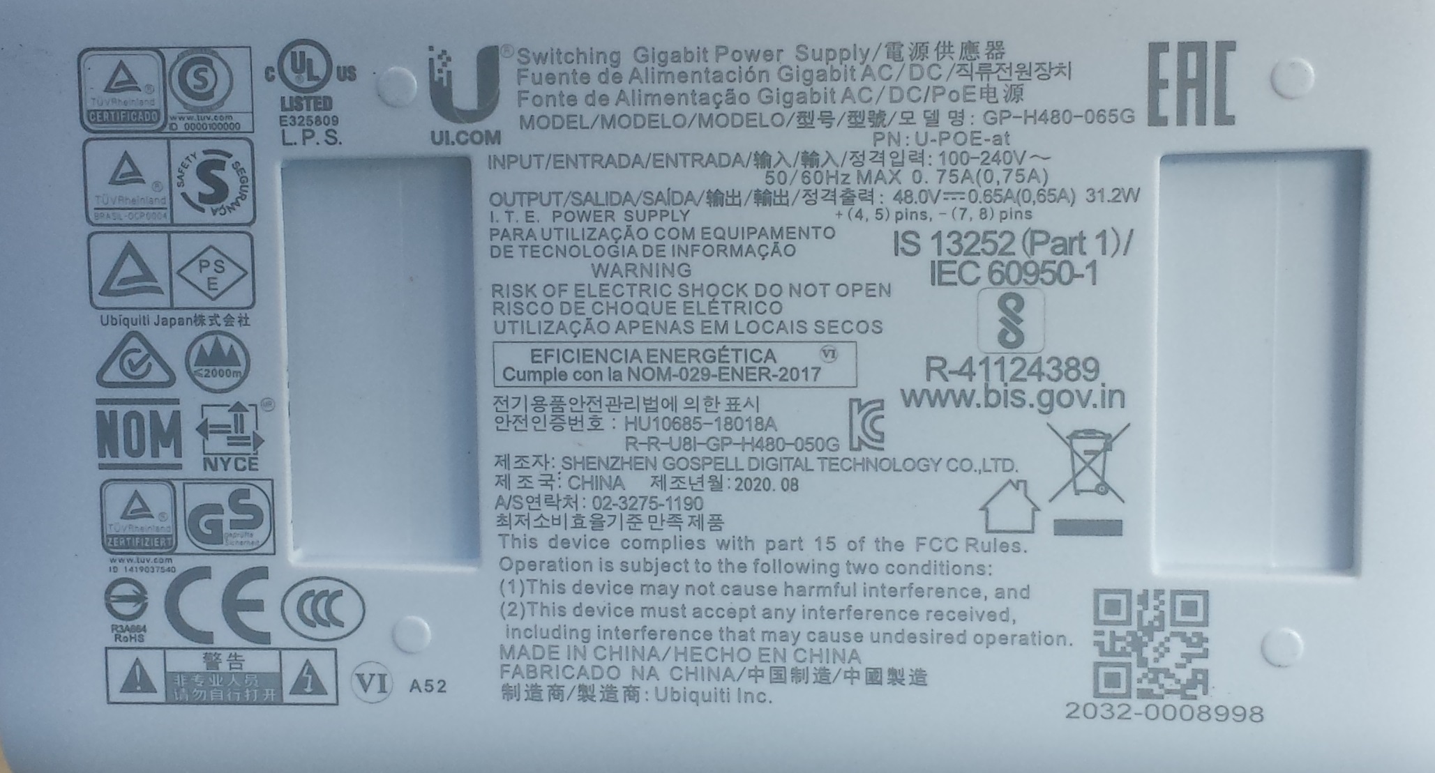

I don't have a AF60 LR yet, so for reference, would you be able to snap a decent resolution pic of the fine-print on the label of the UB POE that came with it ?
Over the years, I have participated in definite cases on the UB forums in the past, where their genius product developers have even managed to do things like use the EXACT same part number on a POE, where one was actually wired as 2-pair power and the other was 4-pair.
So with UB and POE power packs, it never hurts for all of us to triple check, because they can't seem to make things that are logical and consistent. ;)

Re: Ubiquiti AF60 LR POE issue POE Picture added
I will try to get a picture today and post it.

I just got a message from Level 3 support at Ubiquiti:
"If you purchased the AF60-LR from our Early Access store it would be the two-pair POE versions and would have come with a 2-pair POE injector. Units from distributors will be the 4-pair POE version."
I am waiting on a definitive answer about how you can tell by mac id etc.
Now I got mine from Double Radius and the power supply pictured earlier, SAYS it is powering on 2 pairs. Also, I was successful powering up and communicating with Tycon TP-DCDC-2448G-HP
No luck with Netonix WS-8-150 -DC port 2 48 Low or the WS-8-150-AC port 2 48 Low - powers up, won't talk......Ubiquiti suggested not getting enough power.
BTW, these radios have heaters in them , could double the draw in cold weather, i am told.
