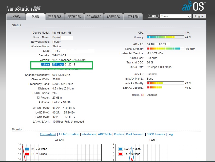

I have connected a nanostation which continues working without restart with another POE feeding on the same Energy as the Netonix
Any Suggestion to this problem

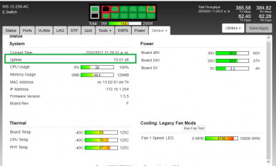

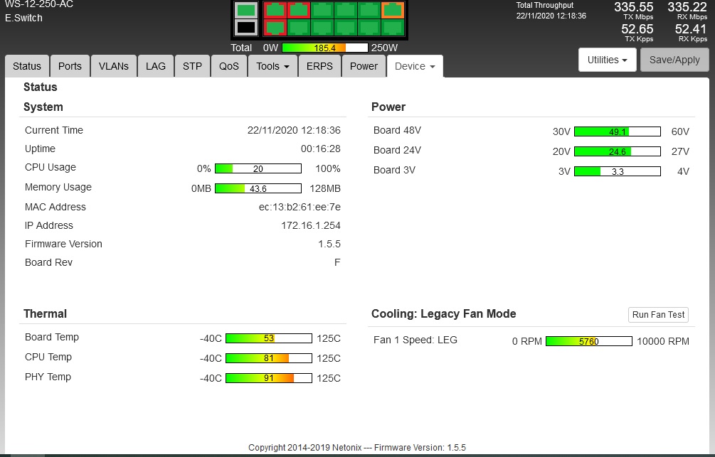

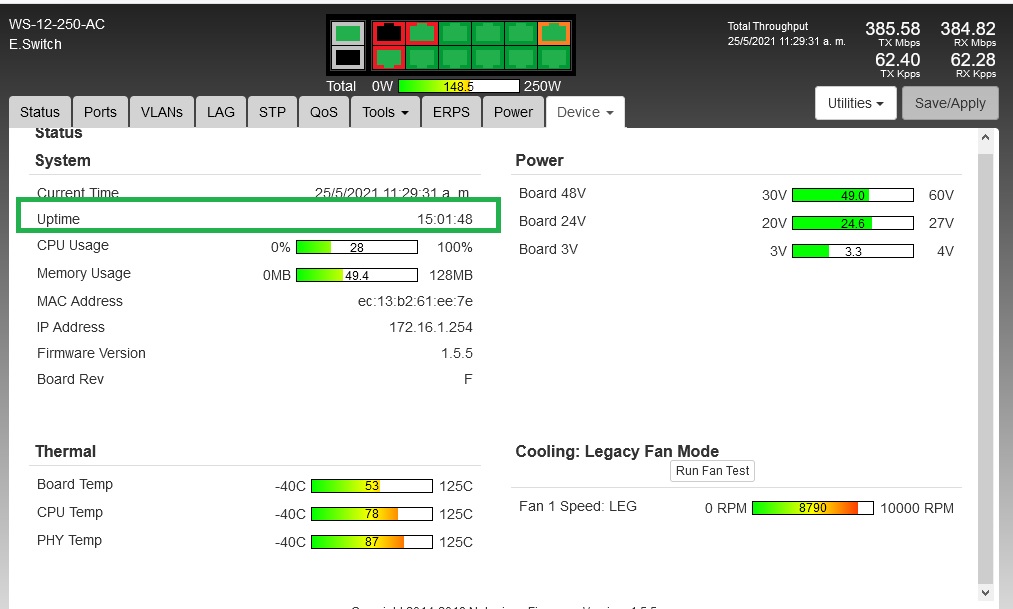

Re: WS-12-250-AC fault reset
Attached is a screenshot of both teams, some recommendation
