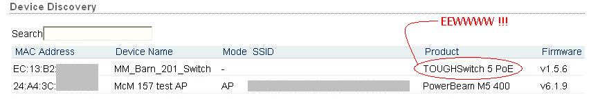

BTW I chuckle when sometimes running UI Discovery from one of their radios GUIs ...
I have seen some of their model-firmware versions will insult the WS by displaying it as a frickin' "ToughSwitch" :pissed:
... that should be grounds for a defamation of character lawsuit ! ;)

JustJoe wrote: have seen some of their model-firmware versions will insult the WS by displaying it as a frickin' "ToughSwitch"
Now I've gotta see that for myself :lol:

Re: WS no UI Discovery reply over VLAN trunk
Wed Oct 21, 2020 4:01 pm
Arrrrgggg

That's great :lol:
