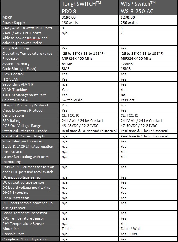

First off let me say that in no way am I saying that the ToughSWITCH™ is not a good product and has many uses that do not need a more powerful WISP Switch™.
Keep in mind that we are building our switches in North America not China which many of you have asked Ubiquiti in the past to build something here which will add to our MSRP.
But I wanted to express why there is an $80.00 difference in price, below is a table showing some of the features the WISP Switch™ WS-8-250-AC can offer over the ToughSWITCH™ Pro 8.
Now if you purchase the ToughSWITCH™ Pro then purchase the RF Armor™ wall mount bracket which costs $30.00 MSRP + shipping so lets say $35.00 the difference in price drops to $45.00.
Also above I forgot to mention the WISP Switch offers COMPLETE SNMP support!
We are also working on many more features like VLAN QinQ support.
As I said though they are both great products.
ToughSWITCH™ vs WISP Switch™ - Why pay more
