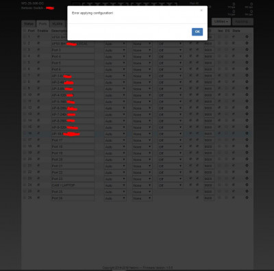

Several resets did not work, so I tried the method to reformat and reset. I let it sit 15 minutes each time, on the second try it finally came back to life.
I started to make small changes and save the config and I made 2 saves and all seemed well.
Then I went to rename the ports, I applied the change and this is what I received.
Is this worthy of an RMA/Replacement. Unit was built in December of 2019 and has made it as far as my bench.

The first issue probably occurred because when you where working on the VLAN tab you changed it so that the port you where plugged into was no longer on the management VLAN. That would prevent all access, for the second, try defaulting the switch.
Utilities->Default
Or in the console via an RS232 cable:
Code: Select all
reload defaults
Then try applying your port name changes again.

Stephen wrote:The first issue probably occurred because when you where working on the VLAN tab you changed it so that the port you where plugged into was no longer on the management VLAN. That would prevent all access, for the second, try defaulting the switch.
Just curious why the Revert Timer failed after applying the settings, coupled with the fact it took a couple hours to get a successful reset. It just seems "strange"
It seems to be running ok now and I made my changes but its just a little concerning as to what could have caused all the issues from the start.
