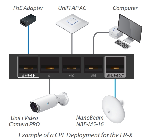

First glance does not pass the sniff test. How are they providing high wattage 48V out with 24V PoE in? Smells like marketing BS to me.
In the following pic, the UAP-AC is 22W and the UVC Pro is 12W. At 24V the current doubles!!

lligetfa wrote:First glance does not pass the sniff test. How are they providing high wattage 48V out with 24V PoE in? Smells like marketing BS to me.
I think in the picture they are assuming the customer is using POE bricks for those devices on ports 1 & 2 as there is only 1 POE pass through port on the ER-X, so only the NanoNEAM on port 4 is actually powered from the router/switch?
Ja, like I said, marketing BS... they trick people into buying based on the picture and then of course when they post on UBNT about why it doesn't do what the picture suggests, they get slammed as dumb for not reading but by then they are UFOs.

by TheHox
So this would be accurate?
(I made that quick)
It fooled me at first, and I know it is fooling others as they talk about it replacing a ToughSwitch 5 port...
:rofl4:
Re: EdgeRouter™ X
Posted: Tue Apr 07, 2015 4:08 pm
by lligetfa
Ja, that's better. I'm a little embarrassed that I let it fool me at first glance.
