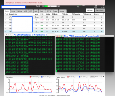

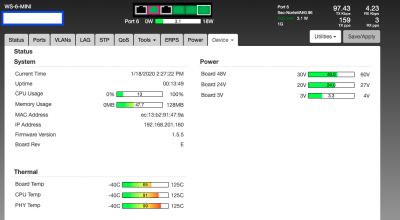

We have a very odd thing happening with a WS-6-MINI
Its GUI is unstable, and when we monitor it and ping it from the gateway it looses A LOT of pings.
However, if you ping the radios that are behind it, they are just fine. Looks like the Software on the mini 6 is having issues and not actually the network?
The Status page is ok, CPU is low. Running 1.5.5. on E board.
It usually has 60-100Mbps of traffic only
Any ideas?
all comments are welcomed.

That's odd.
Can you post the log?
