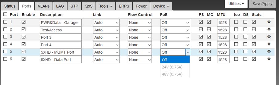

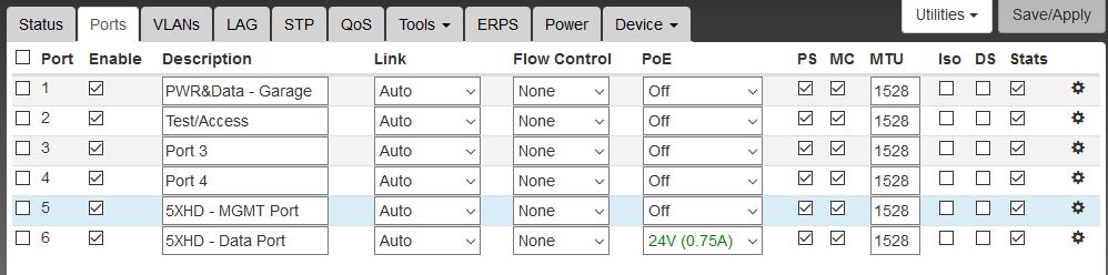

I have a WS-6-Mini being fed with 48VH on port 1 from a WS-8-150-AC. The WS-6-Mini is connected to a Ubiquiti 5XHD on ports 5 and 6. I am able to turn on 24V on port 6 to power the 5xHD, but I would like to have 24V turned on port 5 as well to have a redundant power feed to the 5XHD. When I go to to POE drop down for port 5, both the 24V and 48V power options are grayed out and I am not able to turn on the 24V. At the other end of my PTP I have a WS-12-250-DC connected to both ports on a 5XHD and I am able to turn 24V poe on both ports. Is there something that is limiting me from turning 24V on both ports for the WS-6-Mini? Thanks

If I recall correctly, as a safety measure, you cannot turn on PoE on a port that currently has link.
Try disabling PoE on port 6, than turning PoE on on both ports at the same time.
