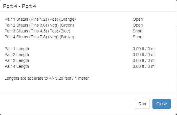

Re: 3.3V CAP problem
When I do cable test, I get this result on an UniFi AP Outdoor+ (48V)
AP is powered with 48V and the port reports 100 Mbps link (like it should)

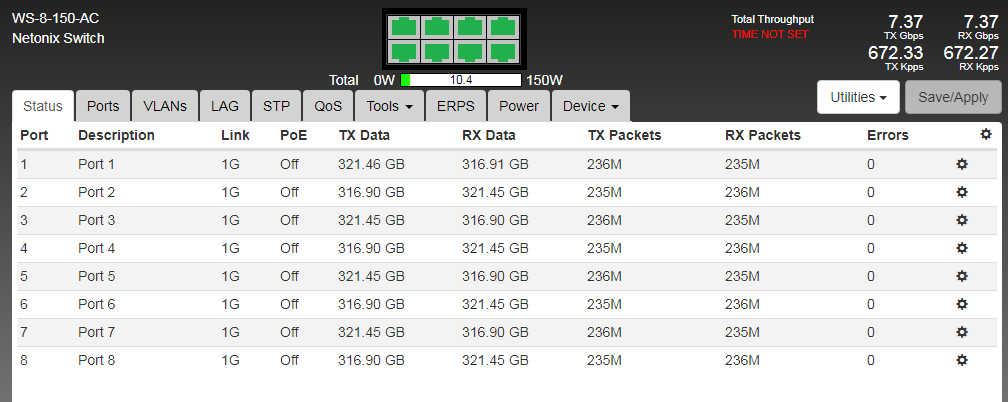

Hmm.....
Just loading all ports and push 1 Gbps traffic through both ways, does not make the switch reboot ??? I'm pretty sure this switch reboots occasionally, especially when all ports are in use.
Just pulled it out of production, as we couldn't add more equipment to it...
Any good ideas how to test with PoE ON ?
jjonsson wrote:When I do cable test, I get this result on an UniFi AP Outdoor+ (48V)
If the device is 10/100 then:
https://forum.netonix.com/viewtopic.php?f=6&t=1178#p8809
Question: Why do I see short on pairs 3 and 4 on a of devices especially UBNT airMAX 10/100 gear.
Answer: Because every manufacturer does not follow the proper design specs and use a 4 channel Ethernet Transformer designed for POE with a center tab for each pair. Since pair 3 and 4 is not needed to carry data with 10/100 only links they use them for power only which allows them to use a cheaper 2 channel transformer without a center tap for pairs 1 and 2. They then connect the 2 wires from each pair to the board skipping the need for a transformer with a center tap so the 2 wires from pair 3 are connected directly to the board shorted together for positive and the 2 wires from pair 4 are shorted together directly on the board for negative.
If the device is 1G then you may have a damaged port or cable/ends, does it do the same in another port?
