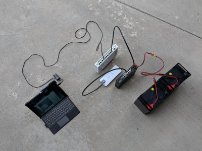

I have simplified this as much as possible for testing.
Test setup
With the power to the rocket off, there is zero packet loss between the mikrotik and the netonix.
The moment power to the rocket turns on, I have 5% packet loss between the mikrotik and the netonix. This is before link is even established between the rocket and the netonix.
Should this test setup work?
All of the new sites I am having this issue with are using new netonix units with the square holes (ec:13:b2:83:*).
I did this test with a unit with circles holes (ec:13:b2:81:65:2c). No problem. Swapped out this netonix at one of the sites having this issue. Problem solved.
Were there any changes around this time? They are both board rev F, power supply board rev B.
