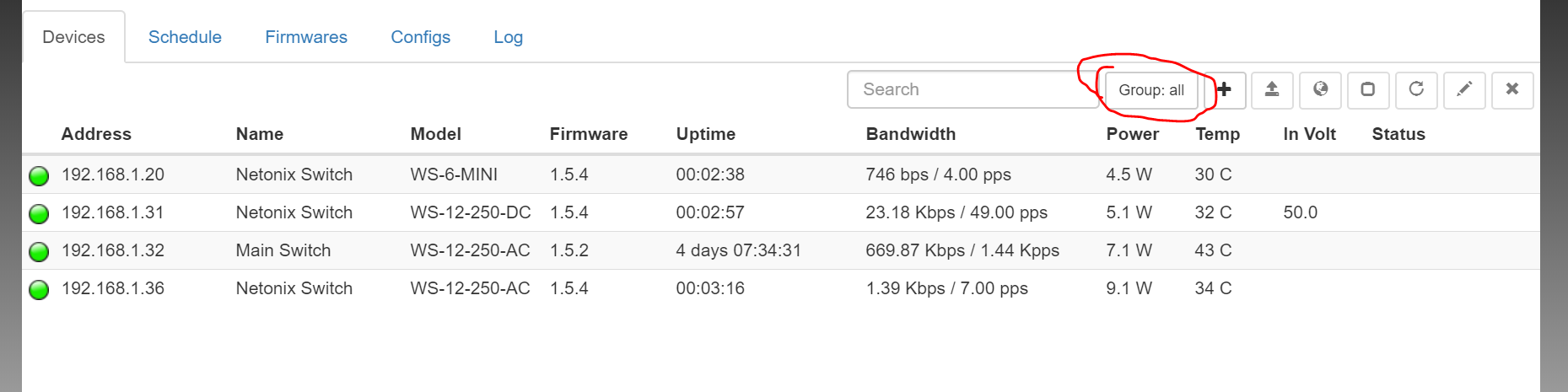

First, click on the new button in top panel called "Group", it should default to "Group: all"

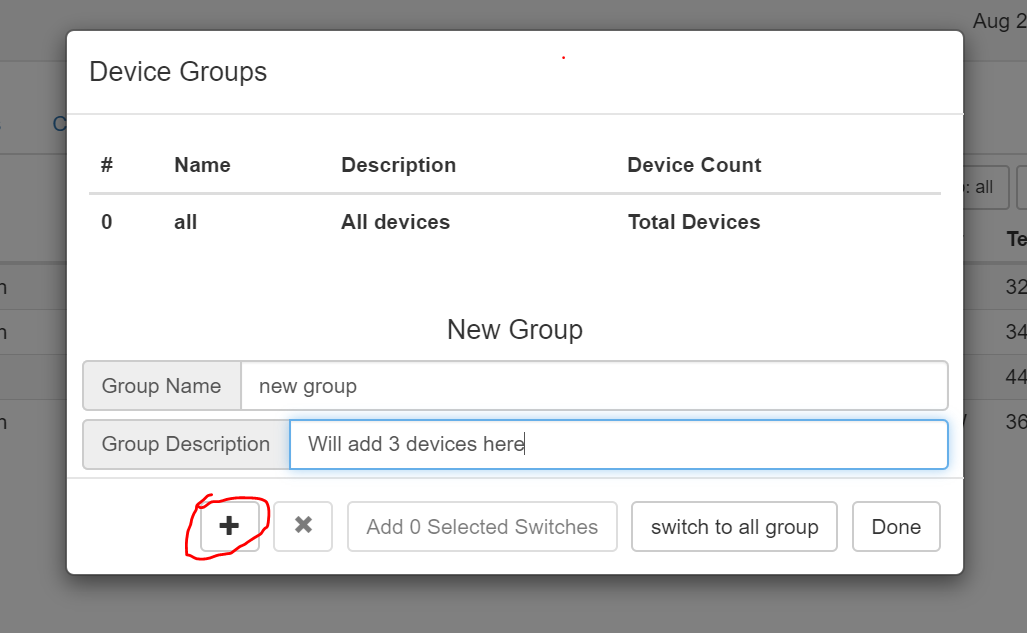

Now, from this dialog you can add a new group, simply type in the name and description of your group and press the "+" symbol.

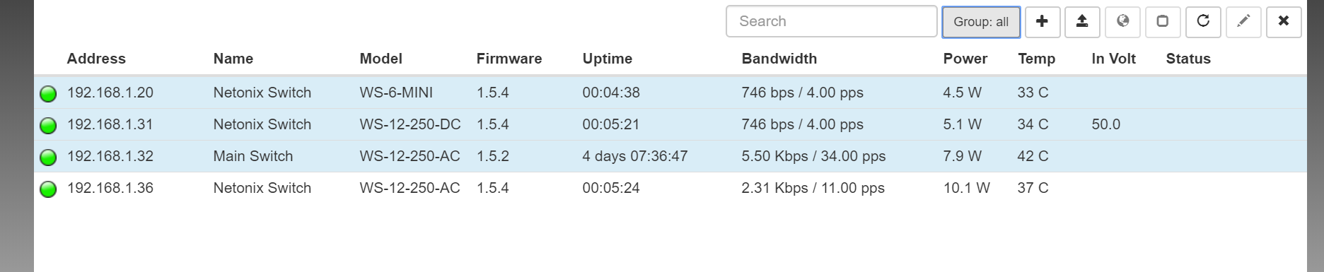

Next, you can select the devices you want in this group by just highlighting them in the device list (you can also choose to select them before you even create the group)

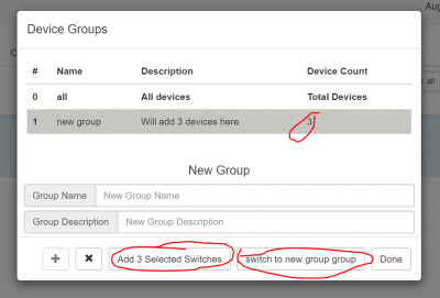

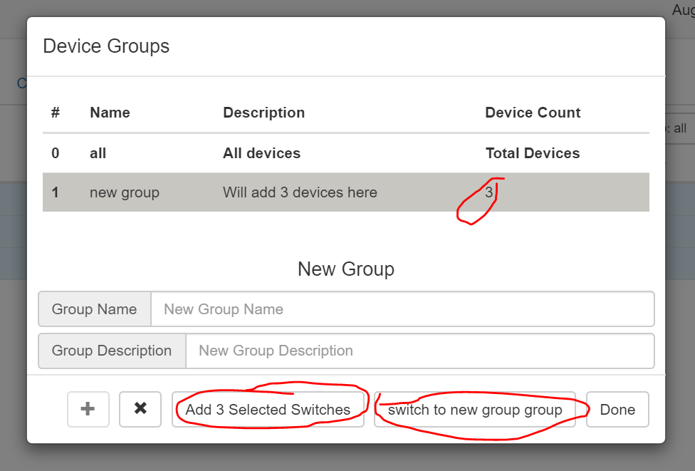

And then open the group dialog again, select your group and click "Add # Selected Switches", then you should see the device count in your selected group match the number of devices you already highlighted.

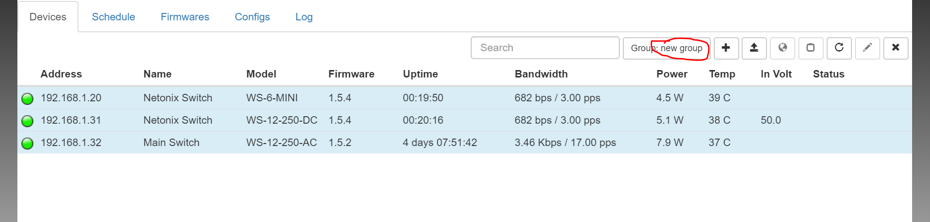

At that point, if you want to view just the devices in that group, with the group selected, simply press "switch to [group name] group" and the device list should update to show only the switches you are interested in. and the button in the menu should reflect which group is selected
