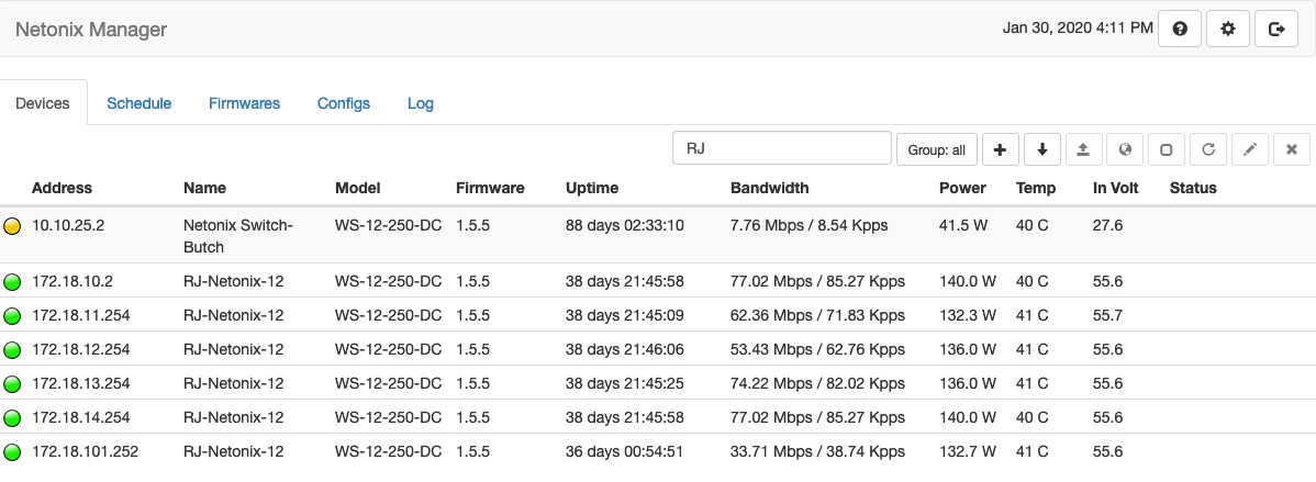

I just finished installing 1.0.15 and when I scanned thorough my network using IP SCAN say 172.18.0.0/16 I found most of my netonix. Everything looks fine
But when looked closely I faced this strange issue where all my netonix are added with duplicate entries for all VLAN monitor IP's as shown in the screenshot.

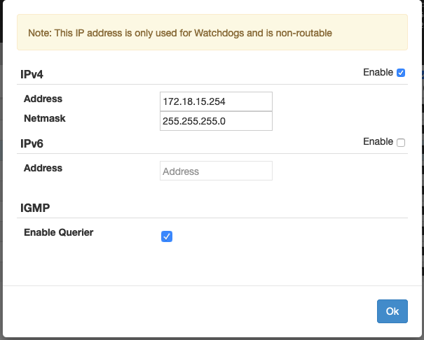

I think the monitor IP are non-routed so how they are found.

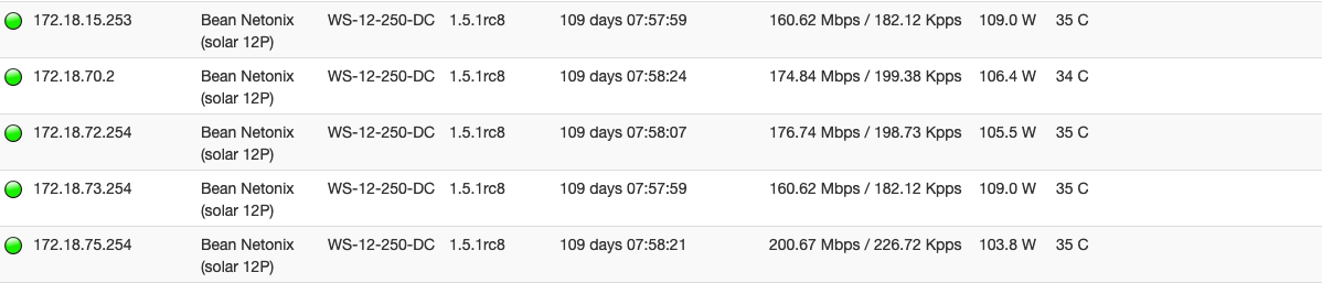

Another issue is that same device have different values.

This does look like a bug of some sort. Little trickier than the other one you reported though. How many devices are on your network?

Yes, I noticed the same monitor VLAN IP getting discovered in recent 1.0.17 version as well.

Viv wrote:... I noticed the same monitor VLAN IP getting discovered in recent 1.0.17 version as well.
I didn't quite get what you mean? Did you mean that the same device is detected twice?
Re: Netonix Manager Discovery
Yes, I mean the same device which have multiple VLAN monitor/watchdogs IP 's(Note: This IP address is only used for Watchdogs and is non-routable) are getting discovered. You can see the screenshot to see how the VLAN monitor IP are added and this screen shot for the problem.
