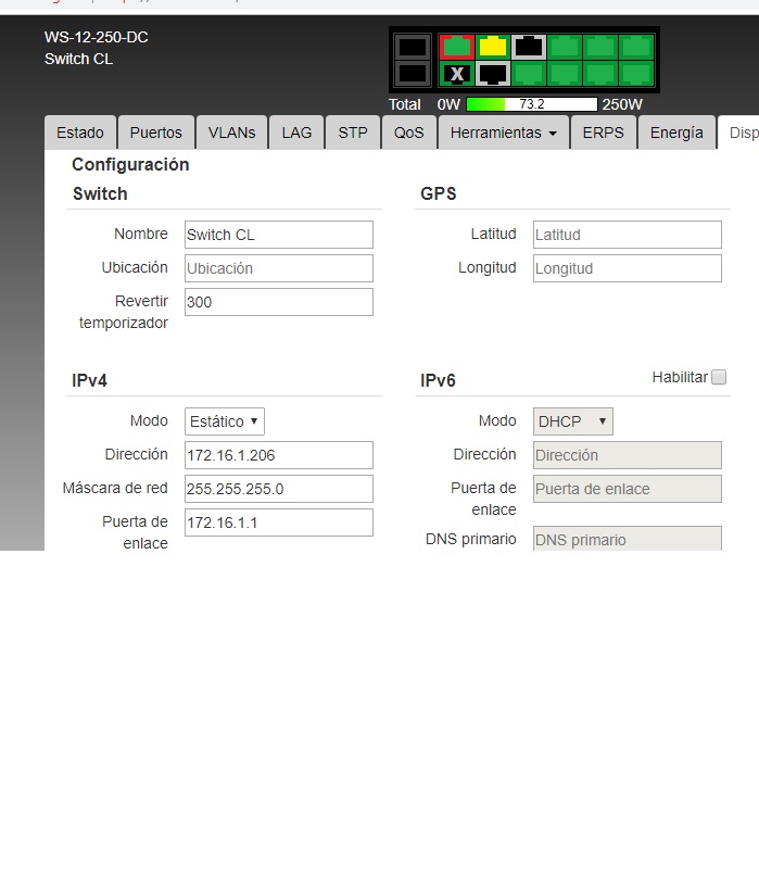

What is the Revert timer set to on the Device/Configuration TAB?

The timer is in 300 seconds.

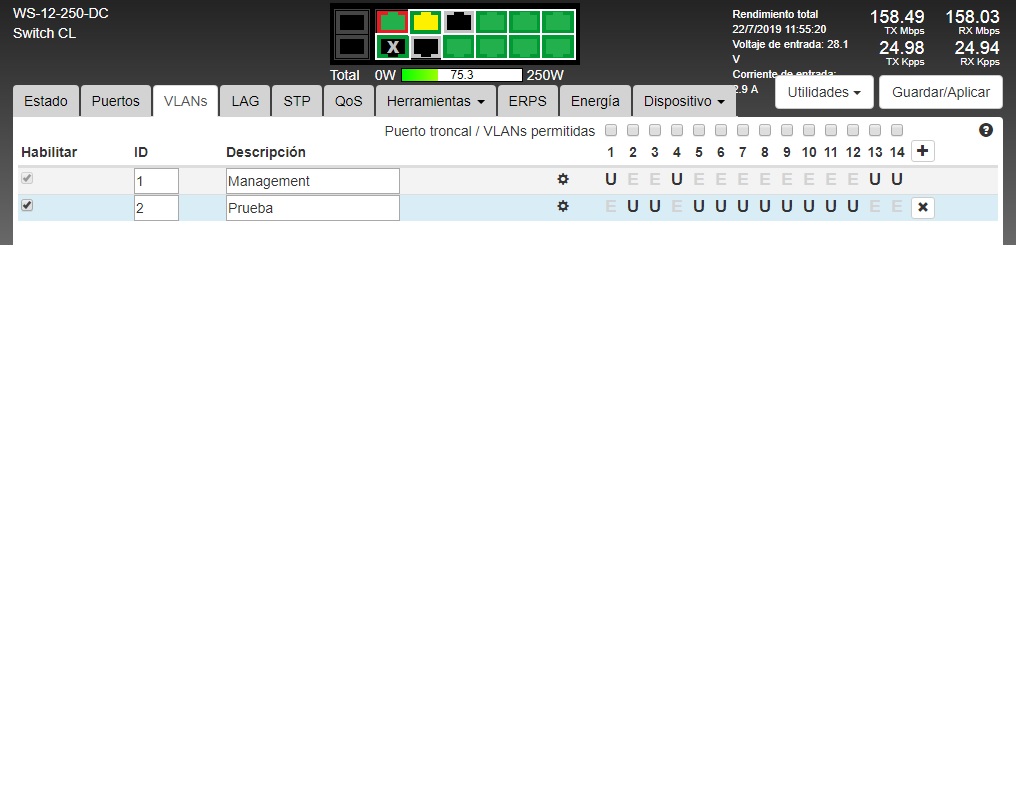

The changes made were the following
Note Both link 1 and link 2 have 10% communication
Enable LAN to port 2
Disable the LAN in Port 1
Added a vLAN look PHOTO
After these changes, the team lost communication and did not return to the previous configuration
Even if you had some momentary error in the order applying the changes you should have returned to the previous configuration before the changes

OK so it looks like there are no sfp ports plugged in, and port 4 is disabled. So you only have access to the management vlan via port 1.
When you say
"Disable the LAN in Port 1"
Do you mean you disabled port 1?
