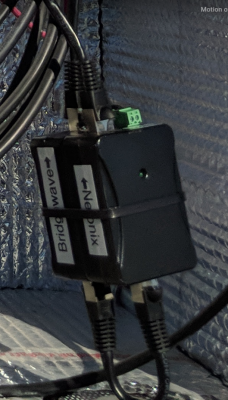

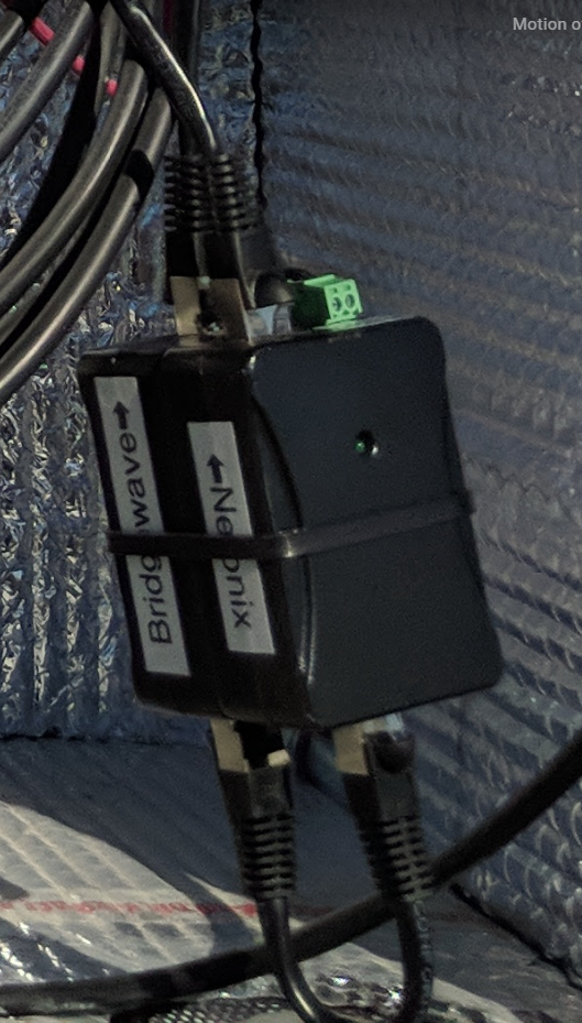

Re: Cambium adapters? Maybe a business opportunity?
I use a pair of TyconPower POE-INJ-1000-WT and POE-INJ-1000-WTx to switch voltage around on pins when necessary. It's ugly, but it works if your device accepts power on all four pins.
POE-INJ-1000-WT to inject or extract when pins 1,2,4,5 are the same and POE-INJ-1000-WTx when pins 3,4,5,6 are the same.
For example:
POE-INJ-1000-WT/POE-INJ-1000-WT can switch from 1,2,4,5+ to 3,6,7,8+
POE-INJ-1000-WT/POE-INJ-1000-WTx can switch from 1,2,4,5+ to 3,4,5,6+ or 1,2,7,8+
Cost $16 + two patch cables and 6" of 2 pair wire.
For example:
