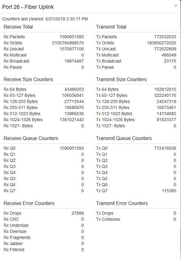

We are getting Rx drops on our SFP port coming out of our router into the netonix. I am not sure what else it could be. We have changed out the router, SFP's, Netonix, and fiber jumper and it still gets Rx drops. Attached is a pic of the drops. I am not sure what else it could be.

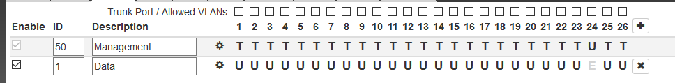

Here is the vlan config. I have this setup with all the other netonix switches.
- Attachments
- Capture.PNG (8.03 KiB) Viewed 15968 times
Re: Rx Drops on SFP port
And the VLAN config from the Juniper ?
What is the MTU size on the SFP port ? Older firmware had a too small MTU by default and not have a preconfigured MTU set to 1528.
I look the stats and most pass through. It's really hard to figure out what is dropped.
We would need a network capture on each side to figure out what is drop or not. Coudl you try a 2008 or even more MTU on the netonix SFP port. From my experience, Neonix SFP port need a littler more than remote device MTU if this device is sending frame at full size.
Does it affect your usage ? Else, it could be rejected network control protocol packets.
I am still getting drops on it. Could it be one of the radios causing this issue you think even though I don't get the drops on those ports?
