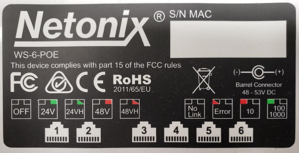

Re: Manual for WS-6-MINI and Red LEDs
You know there is a big sticker on the outside of that switch that explain the lights?
CLICK IMAGE TO VIEW FULL SIZE
