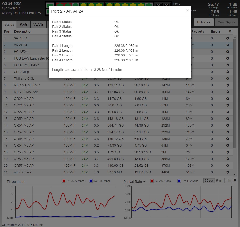

When the radio first boots up and it linked the cable diagnostics show:
Pair 1 Status
Ok
Pair 2 Status
Ok
Pair 3 Status
Ok
Pair 4 Status
Ok
After I lose ethernet the cable diagnostics show:
Pair 1 Status
Abnormal termination
Pair 2 Status
Pair 3 Status
Pair 4 Status
We've put new ends on the cable and still have the same problem. The cable is relatively new and it is a short run on a rooftop.
What could the problem be? Could the AF24 be bad?

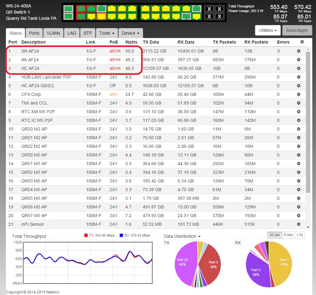

keefe007 wrote: Quick question...when the polyfuse blows why does it still show wattage on the port?
Well it is possible that this is NOT the issue I am describing. You may be having an issue with your airFIBER unit or something else?
If when you can not see the airFIBER unit the switch is still reporting 45+/- watts then the Poly Fuse did not trip.
Now if the board indicates half the wattage say 24+/- then it is possible ONE of the Poly Fuses on that port tripped remember 48VH ports use all 4 pair to deliver the power so each pair carries half the load (2 different Poly Fuses per port)
Also I was talking to Dave and I told him you told me the board temperature was showing around 40C and he told me this would indicate that this is not the Poly Fuse issue so I was wrong with what I told you earlier. The Poly Fuse issue should only happen when the board is over 60C.
But it is entirely possible that this problem is not the switch, guess you need to investigate it more. As I said only a small percentage of those WHITE sticker pre release switches will even exibit the problem. Like I said not all boards that were tested failed during the thermal chamber testing, only a few, some passed.
But at least if people do experience a problem similar they have all the facts to look for.
So in closing this "may" NOT be the defective Poly Fuse issue you are having but you can try the solution above or do as Joe suggested and turn POE OFF on that port and temporarily use the POE brick and see if the problem goes away.
You could very possibly have a failing airFIBER unit or some other problem entirely? - Happy hunting and you know my number if you want to bounce ideas off me.
- keefe007
Re: AF24 Loses Ethernet
I think that may be what is happening...one polyfuse blowing. When this AF24 master is live it is using about 80 watts. When the ethernet link drops it goes to 40 watts.
keefe007 wrote:I think that may be what is happening...one polyfuse blowing. When this AF24 master is live it is using about 80 watts. When the ethernet link drops it goes to 40 watts.
80 Watts?
Dude something is wrong with your airFIBER units or your cables or something?
I have 12 WISP Switches and 26 airFIBER radios and they all report between 47-50 Watts????
80 Watts is 1.6 AMPS which is over the rated port limit, we rate the ports at 1.2 AMPS with this switch model.
Your airFIBERS are drawing WAY TOO MUCH POWER, no wonder they are tripping the Poly Fuses!!!!!
Are you possibly using some sort of Wthernet surge protectors???? If so take them the heck out because maybe they are the reason your sucking so much power!!!
