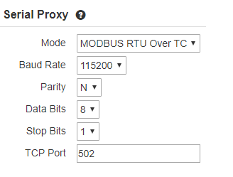

Yes, if you go to the configuration page on the very bottom there is a panel called "Serial Proxy" this is one of the options, it will change the rs232 port to a modbus interface that will allow the switch to act as a tcp proxy.
As shown here:
Modbus Serial Proxy.PNG (5.82 KiB) Viewed 9158 times

That configuration allows using the serial port on the switch to interface with a MODBUS device.
It sounded to me like the OP was looking to use MODBUS to gather data *from* the switch itself.
