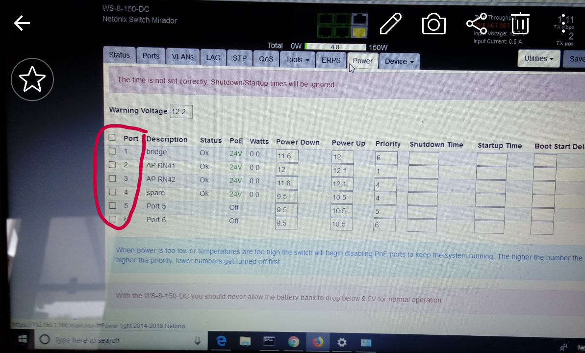

In the netonix wisp dc switch GUI under the power tab, there are some box that can be ticked for each port, does anyone know what they are for?

The Power TAB does differnt things for differnt models.
Maybe specify your model and post up a screen shot showing the fields your asking about.
Re: Question about the power tab in the dc switch GUI
The model is WS-8-150-DC.
OK so those check boxes are present on all TABs with port configurations.
If you select any of those boxes a new line/row appears at the top then any change in that NEW line/row will be applied to all ports/row with that check box checked.
If you select the box at the top of that column it selects all ports then you can deselect individual ports.
A side note, use the Print Screen key on your keyboard then insert/paste into something like MS PAINT and edit the graphic file rather then take a picture with your phone then edit it.
