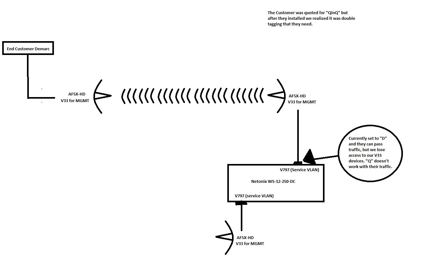

Re: QinQ Traffic - Losing Management
Sorry for the major delay.
Here's a rough outline as to how it is looking so far.
Their traffic can pass when set to "D" on their port, but we lose access to our managment Vlans for our radios.
The 2nd AF5X-HD goes to another site. The VLAN is tagged from devices after that until it hits the customers other end of their Layer 2 connection.
