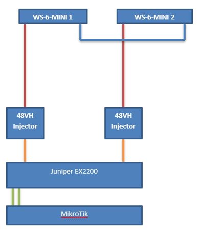

I have a site with the primary router / rack in the basement, and only 2x Cat5e lines running up to the steeple. In the steeple there will be 2x WS-6-MINI switches. I plan to connect them together, what would be the best stable configuration to do so?
The purpose of connecting the switches together is for redundancy in case there is a communications problem with the primary line resulting from port issues or PoE injector issues.
There are multiple VLANs going up to the switches, all VLANs are on both main lines.
[Ideally, I would just have 4 lines running up and run two separate LAGs. It looks like adding wires at this point would be very difficult due to the way the lines were run originally and the building work that has been completed since then.]
Any suggestions?
Thank you, Chris

I fail to see the need to connect the WS-6 switches as the percentage chances of POE injectors failing is very low but if you really want to then do this one way would be to enable STP/RSTP on the Juniper and disable STP on the WS-6 switches, no need for switches to jocky for root in this situation.

Re: Best Configuration for Loop With 2x Netonix "Up Tower"
I am currently running MikroTik PoE routers where the WS-6-MINIs would go. They have been there for 5+ years without a grounding problem, so I'm not expecting one if I switch to Netonix hardware.
I need to add 48V hardware which is my primary reason for switching to the WS-6-MINI. I am currently running OSPF with the 3x routers on site, which may be overkill but allows for flexibility when doing maintenance and for the possibility of any local failure.
I suppose I could just skip out on the blue line. It just seems like such a small effort for a possible reasonable improvement in access (if it is reasonable to do).
The issue that I see is how would you power the other WS-6-Mini if an injector did fail ?
You'd have to do a truck roll to move the cable to port 1 for PoE in, and could replace the injector easier.
If you only needed 4 ports up top, I'd put the two cables in a LAG instead and save an injector and Mini.
jakematic wrote:The issue that I see is how would you power the other WS-6-Mini if an injector did fail ?
If the injector fails to power the switch, definitely, I lose everything. But when an injector fails to pass traffic, then I have a work-around. I've only had that happen a handful of times, but I thought it was enough to be a consideration.
I need 7 ports up top at this point.
