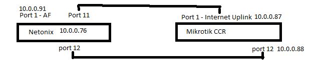

I have tried to follow sirhc example of mid-span port segregation for powering a Airfiber 24 on port 1 and then passing this traffic through port 11 onto a Mikrotik router. However I get port 12 disabled due to a loop. So how do I isolate or segregate the traffic from port 1 to port 11 so that only these two ports see the traffic. Right now the other ports see the traffic and a loop is detected. I have tried different iso options, but I haven't fix the loop.

I suppose my configuration is whacked, but here is what it looks like.
The port feeding the airfiber is my main mikrotik router that handles the handoff from my ISP and all traffic is untagged. This Airfiber ptp uplink feeds a secondary mikrotik router that attaches to the Netonix. The only tagged traffic is between the secondary Mikrotik and the Netonix.
Both routers are on the same subnet. So for instance main router is 10.0.0.1 and secondary router is 10.0.0.87 assigned on port 1 of Mikrotik.
Netonixs ip address is 10.0.0.76.
Airfiber ips are 10.0.0.90 and 10.0.0.91.
Netonix port 1 powers the airfiber, netonix port 12 is hooked to port 12 (ip 10.0.0.88) of the secondary mikrotik router.
So I was thinking this midspan POE from port 1 to 11 should be able to hook into port 1 of the secondary mikrotik for the uplink, like the airfiber POE is currently doing.
So there is a loop, but if port 1 to 11's traffic was truly isolated then I should not have a loop.

It seems like you have a bridge somewhere you shouldn't. anything bridged anywhere?
I think I understand what you're trying to do so you can manage everything and it really seems like ports 1 & 12 are in a bridge.. HOWEVER, even if they are there shouldn't be a loop since you aren't untagged in vlan 100 on port 12. This would make it seem like the WS has a problem..

I just wanted to post a followup to say that I fixed the loop. I had initially put the bridge on the router so I had access while I programmed the Netonix. Once I tried going live with my new router/switch combo while doing the midport span, I had a loop since port 1, 11, 12 had access to each other through the router bridge causing the loop.
To gain management access to the Netonix, I had to use untagged management vlan.
