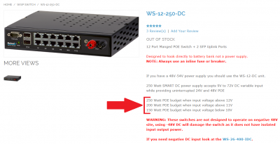

Hello,
I am new to the Netonix community :wink:
I just bought WS-12-250-DC to power many Ubiquiti AF5.
I wonder about the switch's power source, is the 12V enough to connect two AF5 ?
Or is it necessary to connect the switch to 24V ?
Thank you in advance for your advice :thumbsup:

Your PoE budget will depend on how low the voltage drops. when it drops to 11V, the max watts is 200. Lose another volt and it drops to 150.
Re: 12 or 24V for power switch
Mon Feb 25, 2019 12:04 pm
lligetfa wrote:Your PoE budget will depend on how low the voltage drops. when it drops to 11V, the max watts is 200. Lose another volt and it drops to 150.
Les is correct, this information is in the product description on our site.

Hello,
Thank for your reply ! I did not see the picture on your site...
