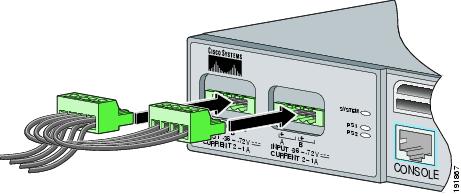

Any reason you guys didn't use these style connectors?

That said, banana plugs are a nice solution to that type of connector on the switch.

Because if we put that connector on most people would not have those connectors and would complain.
Have you seen the inside of the average WISP's cabinets?

Ahem... as the vendor you're suppose to provide the piece that snaps in :)
