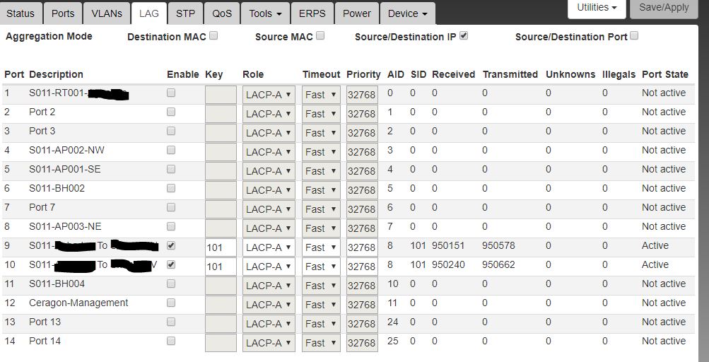

we have two radio links on LAG for past two weeks and so far so good. however we can not access the radios while LAG is enabled. any ideas? hoping to avoid running new cables to the management ports. Using a WS-12-250-DC LACP-A, every thing else is default. Thanks

This makes no sense, please post the following TABs:
Ports, VLAN, LAG, Device/Config, and Status
See my post footer on instruction to upload pictures
Then explain where your computer connects to the network and what the IP of the computer is.

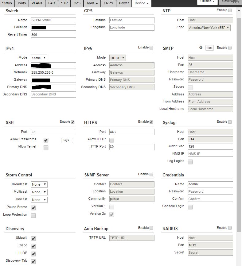

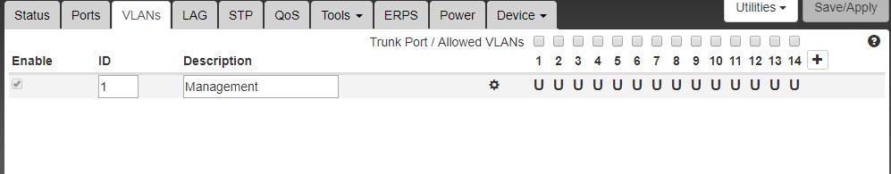

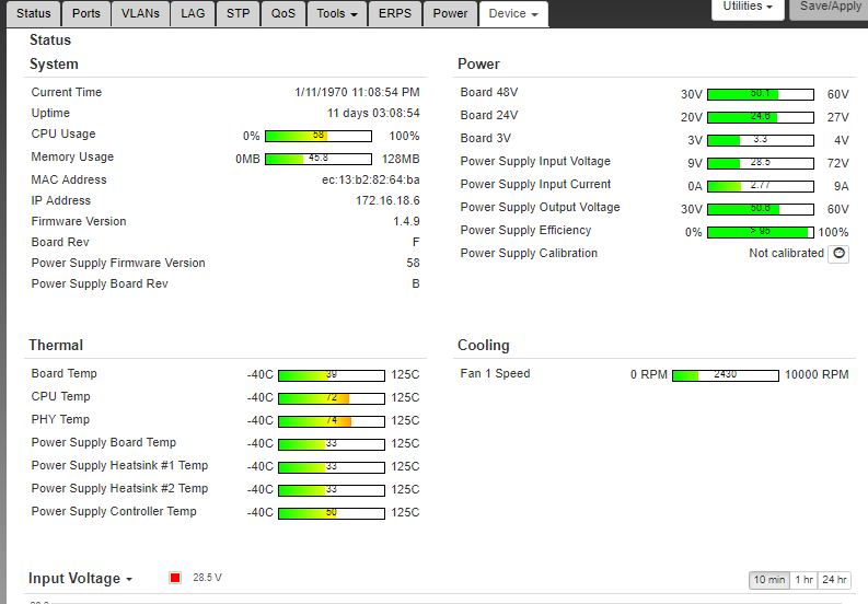

Apologies Sirhc, i did not see the option to add the attachments at the time, now i do. and should now be attached,
Site A has a Mikrotik router with IP 172.16.18.1, connecting to Netonix switch, the switch has ports 9 & 10 set up in LAG. the radios IP are 172.16.18.21 and 172.16.18.22.
Site B is similar, 172.16.18.23 and 172.16.18.24.
when the ports are removed from LAG i have no trouble accessing the radio links.

The firmware you're working with (v1.4.9) is OLD and there was a warning sent out almost a year ago telling people with SMART DC switches to upgrade to v1.5.0 as there is an issue with v1.4.9 and older firmware and the DC power plant. If this unit is not easy to access we had recommended doing the upgrade on site with a spare ready to go if needed. Also there are security updates in each firmware version. Since we run Linux and use open sources packages to run things like our UI/CLI and such these packages upgrade their code in their packages from time to time to patch security holes.

I may have confused the matter, accessing the switch is not an issue at any time, its accessing the radio links when LAG is enabled. so its , PC -> SiteA Mikrotik -> Netonix LAG-> radio1+radio2 --> Site B Radio 3+ radio 4 -> Netonix LAG-> Mikrotik

LACP is designed to work with transparent ethernet -or- fiber cables between the switches. It may not work if you try to pass between any active device (like a wireless bridge). In case that the LACP works, you may not be able to access the management webgui of the wireless bridge devices.
This is a limitation with the LACP protocol.

The idea of LACP is to load balance between 2 links.
How to access wireless bridge A if your flow pass through link B ?
I would try to use 2 differents management VLAN for each link and TAG it only it's related port.
Exemple,
link A management VID 100 connected to port 5 on each switch so you TAG 100 to router uplink and on port 5 of both swich
link B management VID 200 connected to port 6 on each switch so you TAG 200 to router uplink and on port 6 of both swich
DATA on management VID 300 TAGGED (or untag if you don't use CoS) on router uplink and on both port 5 and 6 of both switch.
I never tryed it so I'm not sure how it will work but that what I would try first.
Else, you can use radio with a second port for management the airfiber so 2 cables by radio, use out of band management and configure only the port up to airfiber DATA port in the LAG group.
Exemple,
