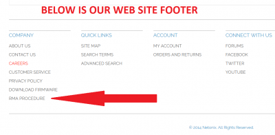

Re: WS-12-250-DC won't power up
WS-12-250-DC Failed, Dead
Where on this forum site is the RMA form ?
Am I blind or is in plain site
cable guy wrote:WS-12-250-DC Failed, Dead
