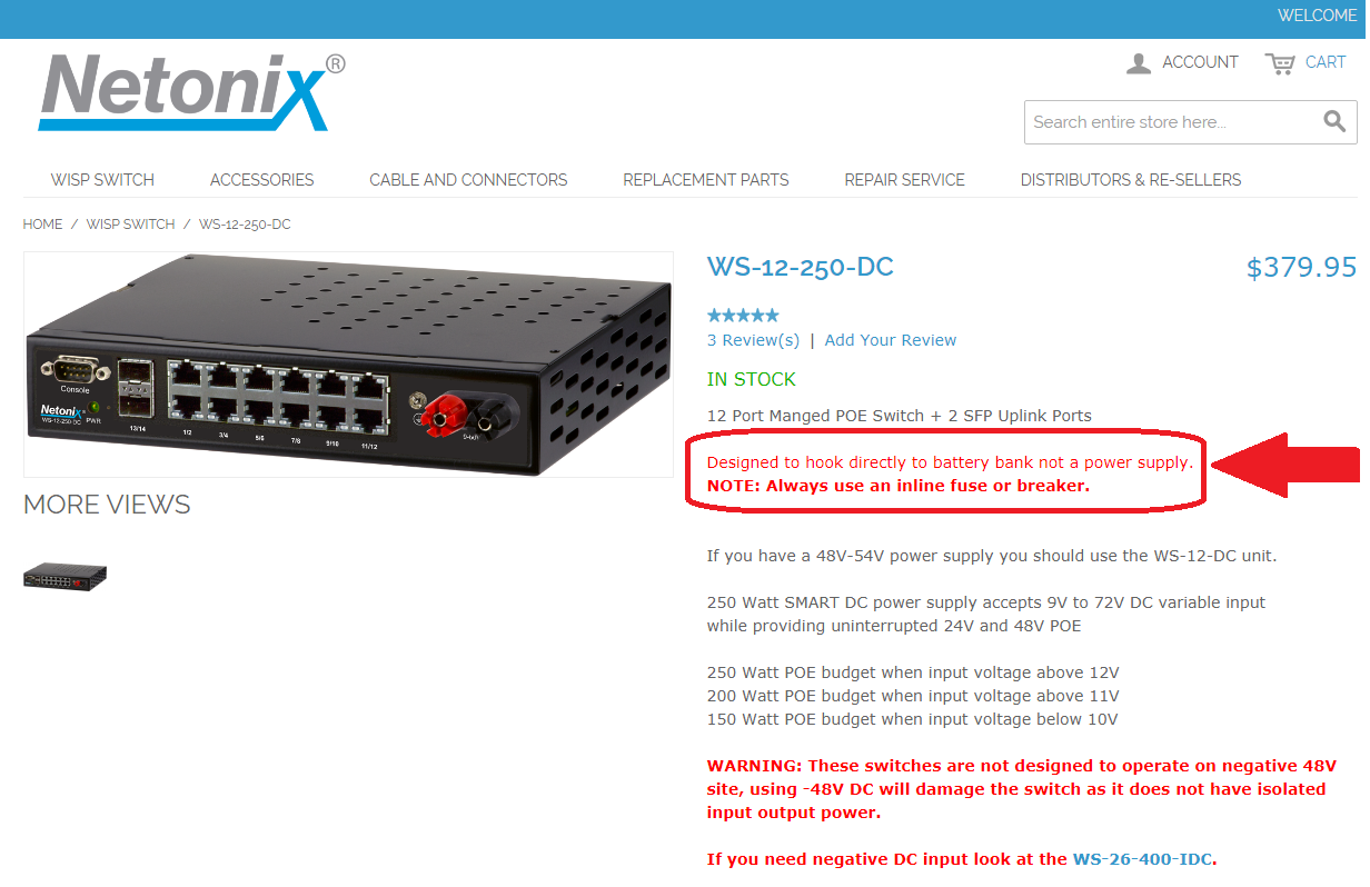

So the product description tells you that the switch will operate if you so desire:
Down to 9V delivering 150 watts or 150W / 9V = 16.7 Amps
Down to 12V delivering 250 watts or 250W / 12W = 20.8 Amps
So your inline fuse or "preferrably" a breaker of 20 to 25 Amps is needed.
WARNING: Discharging your batteries this low in an EMERGENCY will often require a truck roll with charger as most batteries require 10A per battery charger to recover batteries discharged this low but in an EMERGENCY you have this option to keep your site up as long as possible.
A breaker is better than fuse as you do NOT want to spark the connection when connecting and disconnecting the switch from the batteries as this ON - OFF - ON - OFF - ON of power can cause damage to the switch. MAKE SURE CONNECTION IS QUICK AND SOLID NOT SPARKED.
