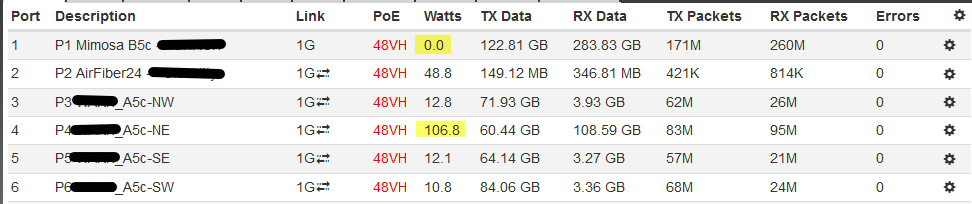

We had a storm roll by yesterday and our switch (WS-26-400-IDC) rebooted. A couple of ports are now showing the wrong wattage output. I'm guessing the sensors were blown on these ports but yet they are still functioning normally. My guess is ESD. Thoughts? Haven't been down to look at grounding issues at the site.
