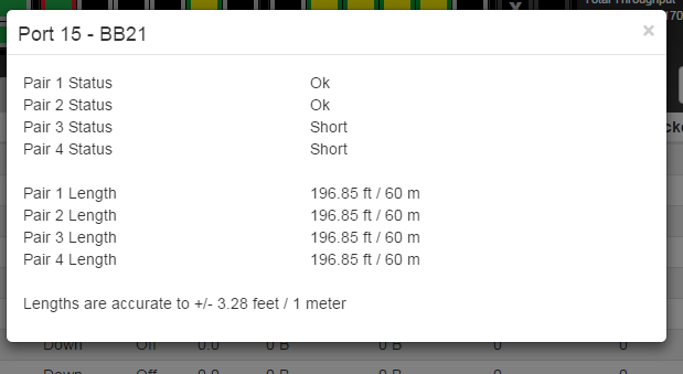

Regular airMAX radios should report:
Pair 1: OK
Pair 2: OK
Pair 3: SHORT (this is the positive pair)
Pair 4: SHORT (this is the negative pair)
CLICK ON IMAGE BELOW TO MAKE FULL SIZE

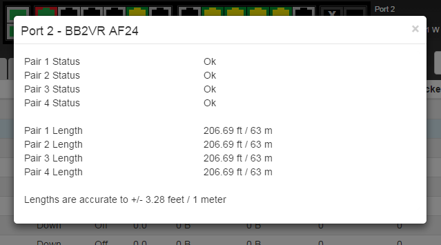

1 Gig radios or 802.3af/at devices should report:
Pair 1: OK
Pair 2: OK
Pair 3: OK
Pair 4: OK
