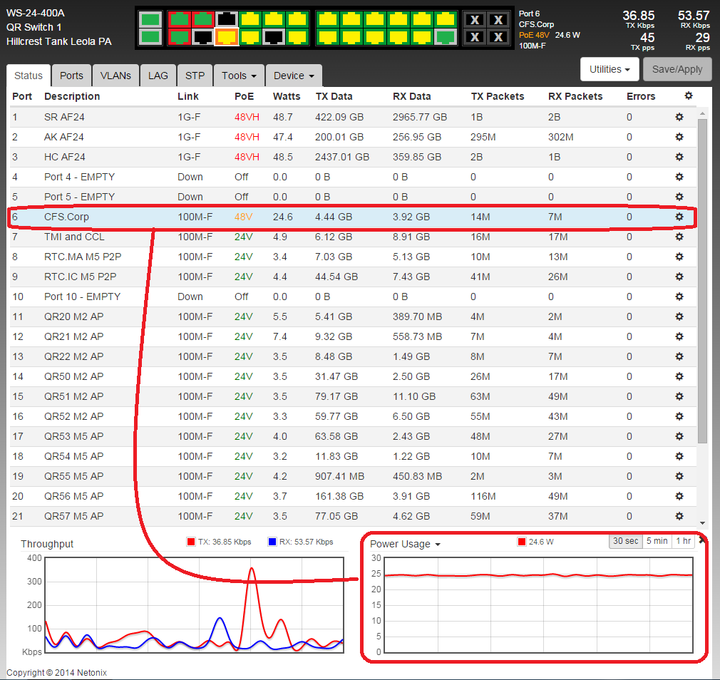

Actually with 24V or 48V POE selected using pins 4, 5, 7, 8 you can power a radio up to 25+/- watts constant draw with no problem or 50+/- watts constant draw with 48VH using all 4 pairs.
In the image below I am powering an SAF 106 link.

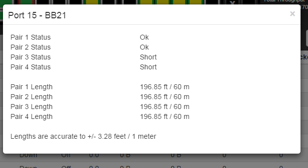

This is why I also make my installers un-power POE ports before they mess with the cable or radio on that port and always run a cable diagnostic BEFORE you restore power and NEVER restore power if the diagnostics report a "CROSS SHORT" meaning one pair is shorted to another pair or you will damage your equipment!!!
Regular airMAX radios should report:
Pair 1: OK
Pair 2: OK
Pair 3: SHORT (this is the positive pair)
Pair 4: SHORT (this is the negative pair)

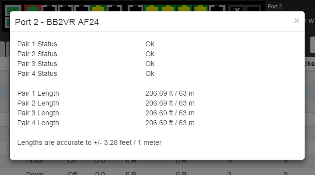

1 Gig radios or 802.3af/at devices should report:
Pair 1: OK
Pair 2: OK
Pair 3: OK
Pair 4: OK
CLICK ON IMAGE BELOW TO MAKE FULL SIZE
If the cable diagnostics reports pair length mismatches this is an indication of damaged cable that has been kinked or stretched. - REPLACE IT

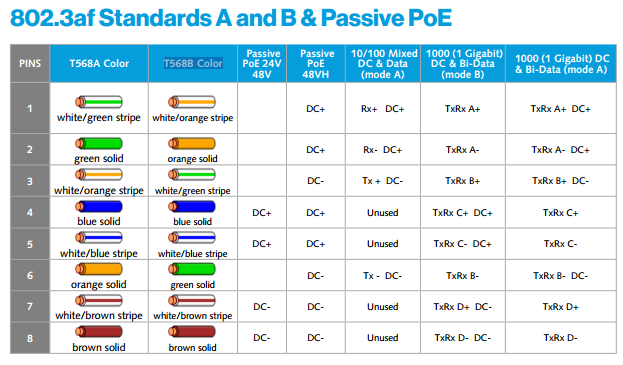

Dave, could I please get clarification on what you mean by wire pair? Do you mean two conductors in parallel both carrying the same polarity (fe 4&5) or one + and one -?Dave wrote:per wire pair
Do you have a schematic drawing?
Re: Powered RB1100AH?
lligetfa wrote:Dave, could I please get clarification on what you mean by wire pair? Do you mean two conductors in parallel both carrying the same polarity (fe 4&5) or one + and one -?Dave wrote:per wire pair
When he is saying per wire he is meaning the 2 wires of the same color bonded together.
There are 4 pairs in the CAT5 Cable
When using 48VH on the special ports
Orange - carriers positive voltage together - BONDED TOGETHER for DC voltage
Green - carriers negative voltage together - BONDED TOGETHER for DC voltage
Blue - carriers positive voltage together - BONDED TOGETHER for DC voltage
Brown - carriers negative voltage together - BONDED TOGETHER for DC voltage
When using 24V or 48V on any ports

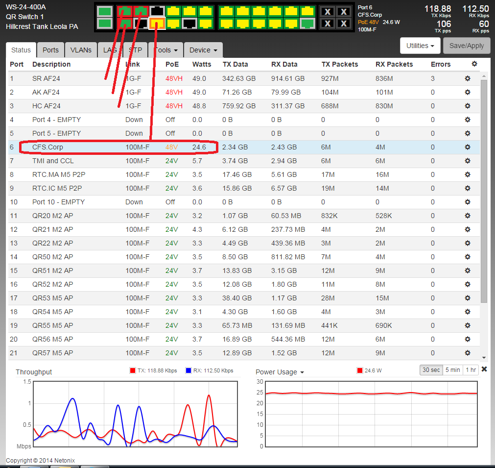

Also those are recommended constant draw limits, meaning guaranteed to work and not damage your switch.
See below I have a 48V Standard in port 6 pulling 24-26 watts powering an SAF 106 link.
CLICK IMAGE TO SEE FULL SIZE
