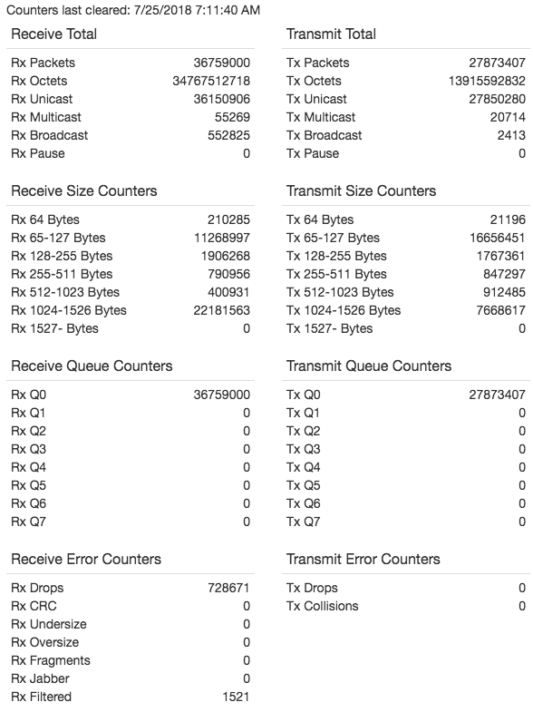

Has anyone else experienced a high amount of RX Drops on the WISP Switch?
We're seeing stats like this across the board on multiple switches with different APs (Cambium, Netonix, Ubiquiti etc)
RX Drops

s7stem-abotbyl wrote:Has anyone else experienced a high amount of RX Drops on the WISP Switch?
Yes, I'm seeing one switch do the same thing. I'm pushing about 30megs of traffic through this one WS-MINI and getting about 2% Rx Drops.
I've only started looking for it after customer complaints. I'm not sure what the problem is yet. Did you resolve your issue? We are running the latest firmware.
At this point I don't suspect it to be an issue with the netonix design. I have 10 other WS-MINIs and their RX drops are very minuscule if any.
This could be a network issue or a faulty component somewhere. I'm going to have to investigate. Our Rx Drops are incrementing like crazy on this one.

Re: RX Drops
Have you made any VLAN changes to the switch?
Specifically, have you deleted VLAN1 ?
I've just noticed that some of my RX drops are related to the fact that I have removed VLAN1 from the switch (I'm not using it).
There must be some traffic on my network without any tags coming into the WS-MINI and getting dropped at the ingress. I'll have to sort that out, but after I added VLAN1 and assigned it "U" to the ingress port, a significant number of my RX drops stopped. I probably have another issue that is causing the others. I'll have to continue to investigate.
