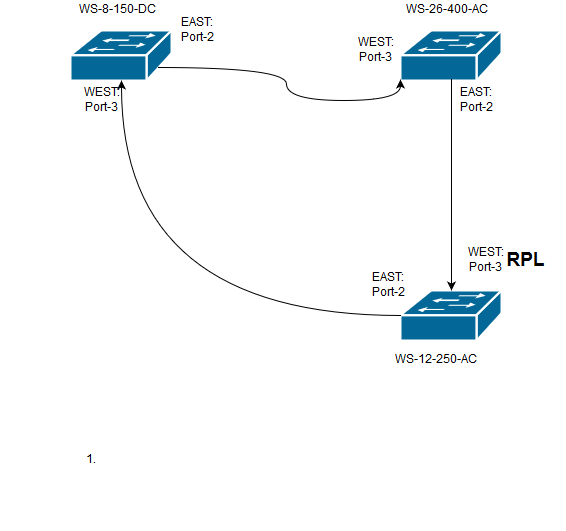

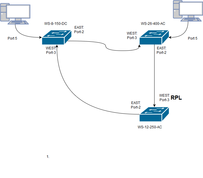

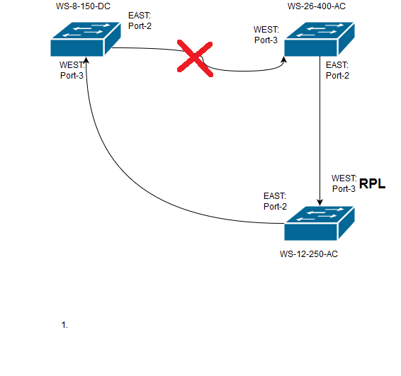

Here is the network diagram of my lab setup for ERPS.
Figure 1
(Note, it doesn’t matter what switches you choose to use this is simply based on what was available in my lab environment)

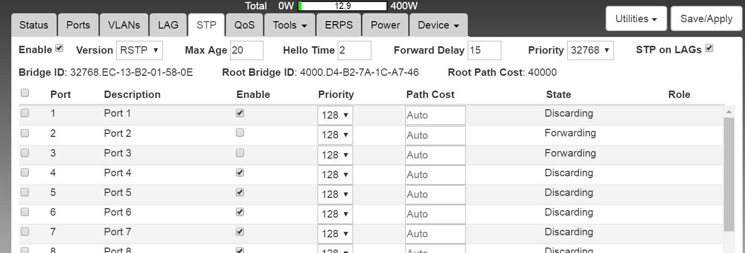

First disable STP on all ports that will be part of the Ring.
Since STP is also trying to control when ports are forwarding or discarding it’s possible for it to interfere with ERPS.
Figure 2

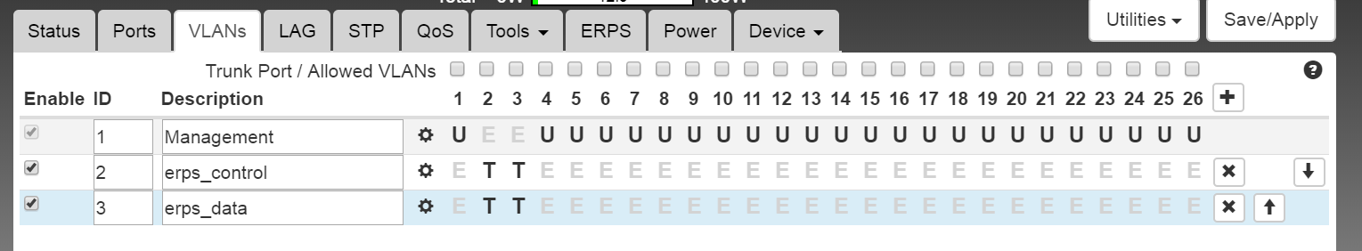

Second we need to build a VLAN for the control signals and a VLAN that we want to use for user data.
Figure 3
It's important that we make sure that the control VLAN for ERPS is separate from the management VLAN otherwise the management VLAN will be flooded with R-APS packets causing us to lose access to our switch.

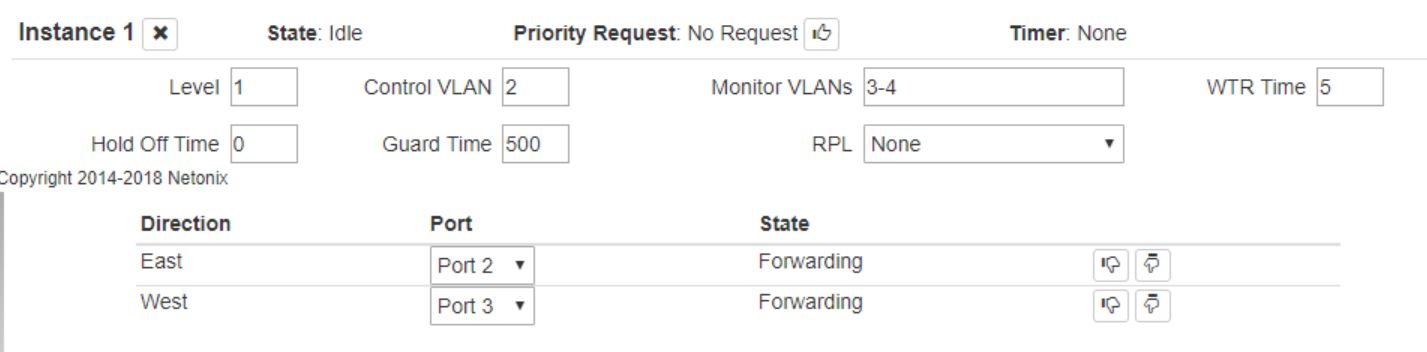

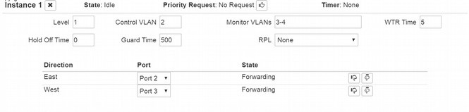

Go to the ERPS Tab and insert a new “ERPS instance”.
For the ring to be functional we only need to enter the following fields:
level, set it to 1, the control VLAN, and the monitor VLANs, finally set the East and West port according to the topology we described in the diagram. In my case, to make things simple I have set the East port to be 2 and West 3.
Figure 4
Do this for all the switches in the ring.

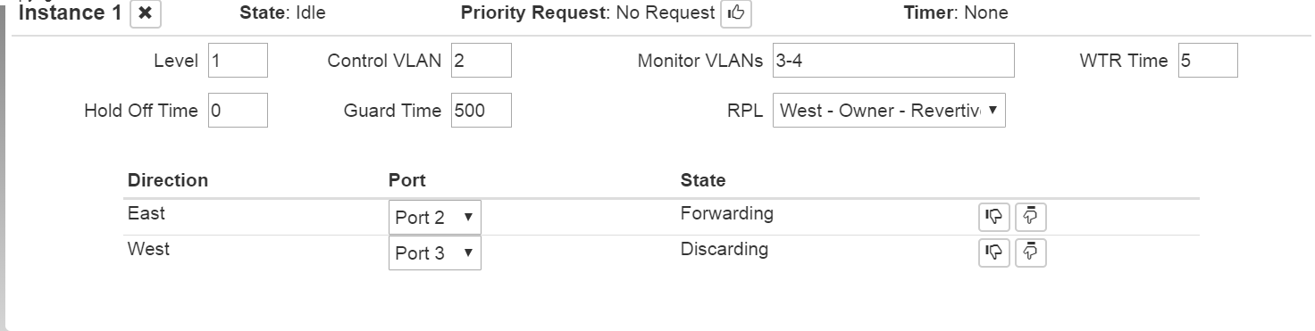

Now we need to select the port on one of the switches to act as the RPL or a Ring Protection Link. This is going to be the link that by default is discarding packets unless there is a detected break elsewhere in the ring. Should a break occur the selected RPL will begin forwarding packets until the broken segment recovers. On my topology I have selected the West Port on the WS-12-250-AC.
To make this selection, in “Instance 1” set the RPL option to “West – Owner – Revertive”

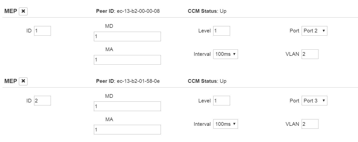

Now we need to setup a monitoring service for the ring that will trigger ERPS should a break occur. This is commonly done with MEPs, or Maintence Association End Points, which can be configured to monitor each segment.
We are going to need two MEP instance’s for each switch so go back to the ERPS tab and add a new MEP,
Set the ID to 1, MD and MA to 1, and level 1, set the VLAN to the control VLAN value and select either the East or West port to be monitored.
Next create one more MEP instance and do the same thing except set the ID to 2 and select the other port to be monitored, as in the following figure:
Figure 6
Do this for each switch and save the configuration.
This should be the last step necessary to get a functional ring. Double check the ERPS tab on all your switches and if everything looks correct, plug in the final Ethernet cable. BE VERY CAUTIOUS BECAUSE IF ANYTHING IS CONFIGURED WRONG IT COULD RESULT IN A LOOP.
If everything goes well, then you should see on all the switches that the CCM status for both MEPs is “UP” and the Peer ID on each MEP instance will be the MAC address of the connected port.

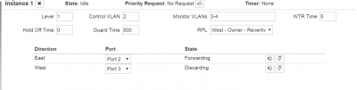

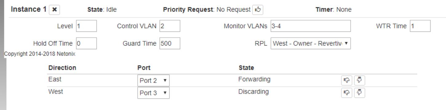

As long as there are currently no issues, instance one in the ERPS tab should read such that the current state is Idle, priority request is no request, and the timer is none. This is basically equivalent of saying no errors have been detected in the ring and everything is operating normally
Figure 9
If we look on the RPL owner switch we will see that the east port is in the state of forwarding and the Westport is in a state of discarding. This is of course because the Westport is the ring protection link.
If we look at any other node we should see that everything is the same except that both the East and the West Port are forwarding

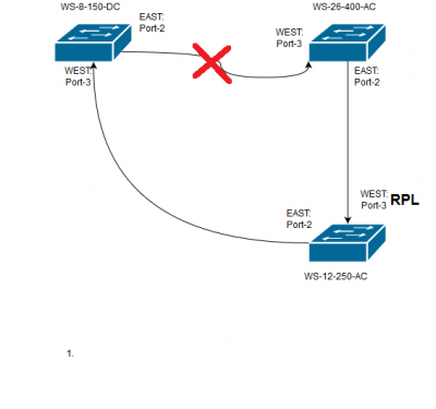

Now I disconnect the link between the WS-26-400-AC and the WS-8-150-DC as in the following figure
Figure 11

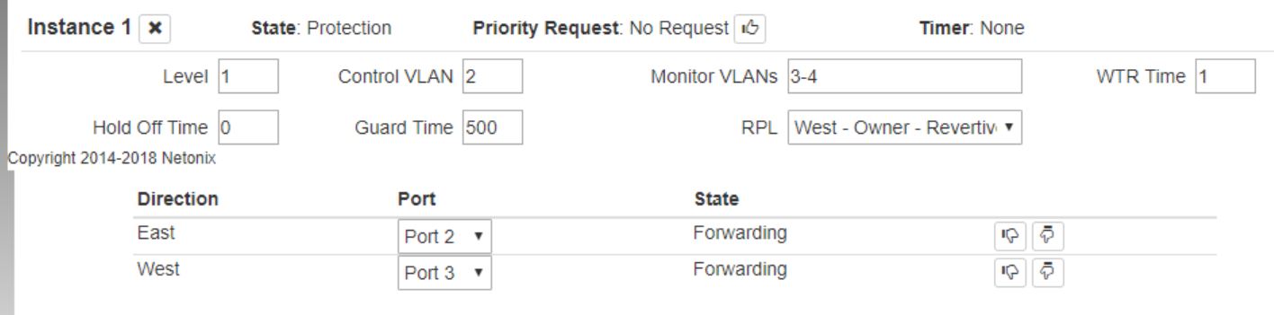

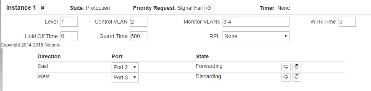

Immediately the ring responds by shifting to a pending state and shortly there after the state will be read as protection which is triggered by the R-APS message packet signal fail request. The Ring Protection Link or RPL port then responds by beginning to forward traffic as long as we stay in the protection state.
ERPS tab of RPL owner
Figure 12
ERPS tab of both other nodes
Figure 13

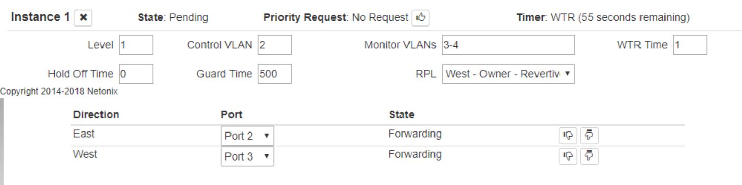

And finally plugging the cable back in the results in the Ring shifting back to a pending state because the MEPS have detected that the connection is now capable of transmitting again. However ERPS will not allow the link to be reestablished until after the WTR (or Wait To Restore) timer expires which by default is set to 5 minutes and can be dropped down to as low as one minute. Once the countdown is completed the ring shifts back to idle and the RPL goes back to discarding
RPL owner waiting for WTR timer to expire before shifting back to idle state

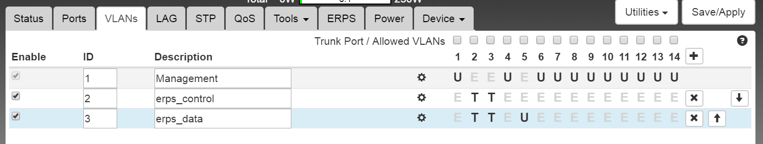

Here are the necessary changes on the VLAN tab that allow packets to transfer through the ring to the Target device.
Figure 8
Specifically, disable the management vlan on port 5 and enable port 5 as Untagged on the data VLAN.
It is important to keep in mind that the control and data VLANs themselves need to be separate from the management VLAN for both security and functionality. So if you need to access the switches web UI, telnet, or ssh console then you must have an Ethernet connection to a port still within the management VLAN from the device you wish to use to access the switch for configuration.
