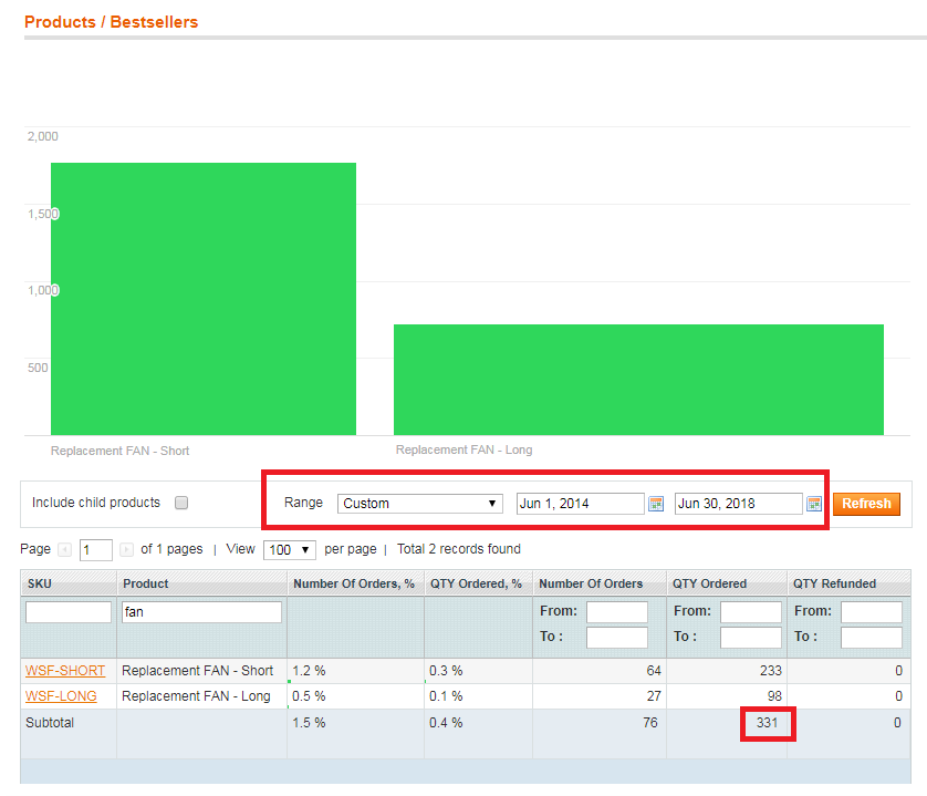

Well either people are throwing their switches away when a fan fails or buying fans somewhere else which I doubt because we are selling less than they can get as we sell replacement fans basically at cost.
To come up with my percentage of failures I looked at how many RMA's were fan replacement and how many replacement fans we sold.
