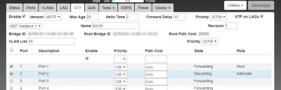

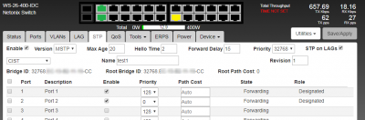

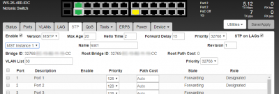

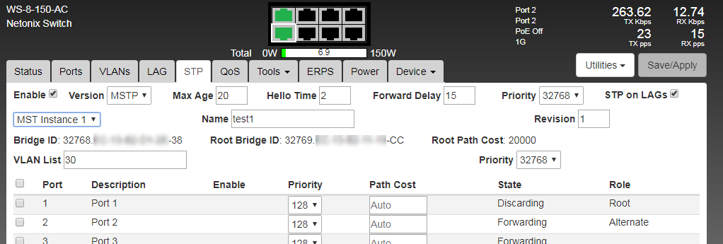

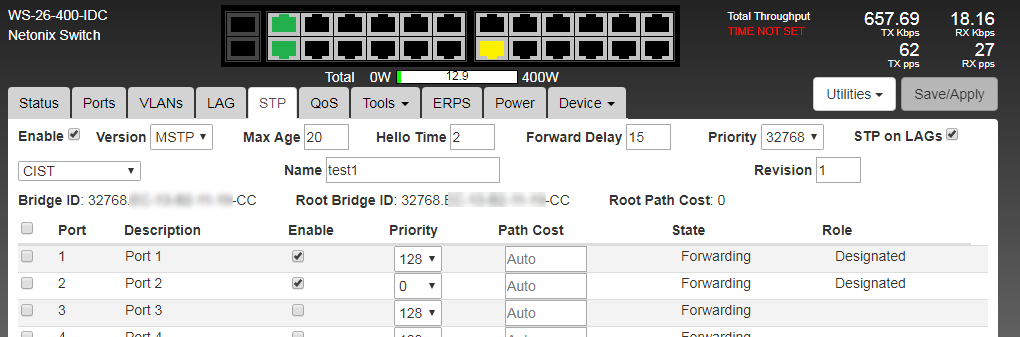

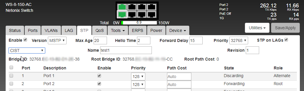

I am trying to setup a simple ring with MSTP. I want the untagged management vlan blocked on one port and pick one path over the other. And then I have a vlan between two netonix on one link I never want blocked. I can get RSTP working and blocking what I need. When I setup MSTP, I can not keep the vlans passing. I setup the names and revision number on all the switches to the same. I select ports on CIST. I have tried setting up instance 1 on just the two netonix with the vlan, and also vlan 1 in instance 1 on all switches and then instance 2 with the vlan. The vlan always gets blocked along with the port/untagged. Can I get some help with this config? When I select the instances, it shows what is blocking and forwarding per instance correct? I see an enable on the instaces pages but cant enable per port or save. Is this normal?

Please post the 2 switch config for both instance and don't hide name.

two switches. vlan 30 tagged on port one only.

Re: Simple MSTP ring setup help
You should explain what you want to do first.
From what I see, you only changed priority in CIST. You must set a lower priority or lower cost on port you want STP to choose and do it on both switch.
If you want instannce 1 to pass through port 1, then set a lower priority or lower cost on this port on both switch. You can also set an higher priority or cost on port 2 instead.
You should read on priority and cost but in larger network, cost is a better option while priority is fine if you want to control the behavior only between 2 switch.
