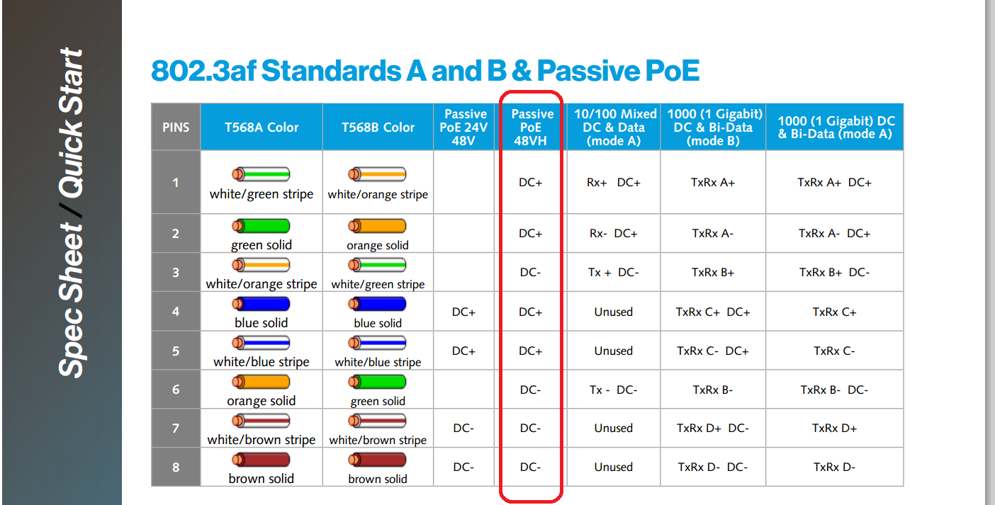

Post up the pin out
if it is 802.3at then 48VH port should work fine if pin outs are the same which it should be (reference our PDF)
CLICK IMAGE TO SEE FULL SIZE

I'm pretty sure that I checked and it was the same. now I can't find the pinout. I'll keep looking.

If the WS support 802.3at it should work.. I can't find anything on the mimosa website that shows the actual pins used. but your diagram looks like like any other standard 802.3at pin out. hmm..
http://help.mimosa.co/backhaul-faq-non-mimosa-poe
