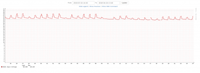

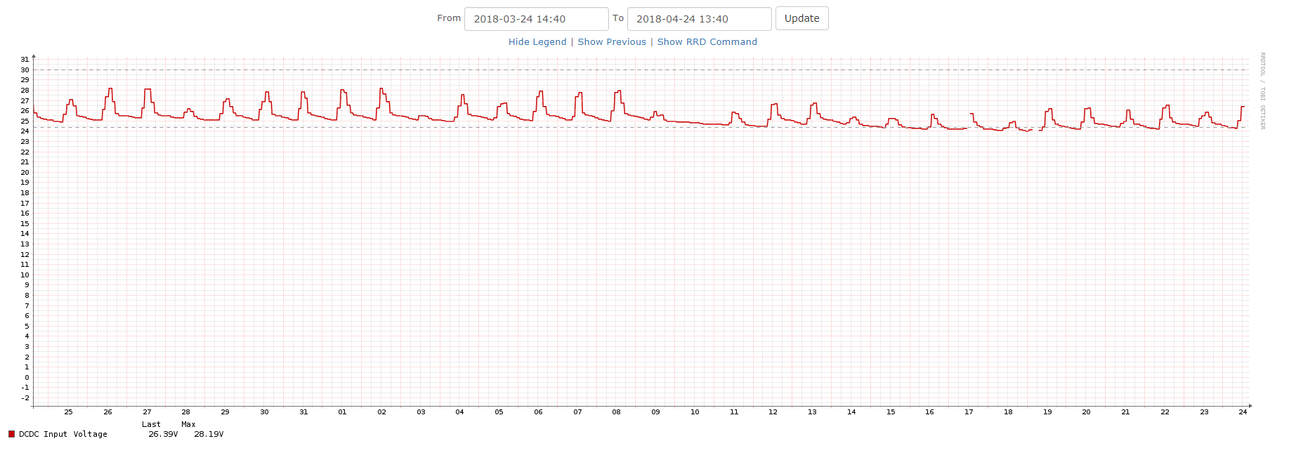

However, as a WISP operator...honestly this is quite valid and not some obscure request. I can appreciate it complicates the GUI but it's not terribly difficult logic to code.
I've got 28 Netonix's out there (we've got another 31 sites to convert) and all but 4 of them are on solar sites (and even on the powered sites we normally run DC netonix with battery backup as remote sites get a LOT of power cuts). If solar panels are covered in Snow or there are multiple dark days then customers are understanding and not too annoyed if there's no Internet in the early hours. Therefore if we can't gain access to the site with fresh batteries or chargers we switch off certain radios. I know at least 2 other WISPs who do similar. Example in attachment, we had to switch off radios on 15th - 17th to keep site up until we could do emergency repairs on the 18th
1) It's good that with Netonix I can get SNMP alerts when voltages on a site are low.
2) It's good that I can then log in and schedule shutdown/startup times on radios to prolong the working time of the site (certainly beats setting alarm for 1am and 6.30am and doing it manually).
It would be better if step 2 could be automated as a result of step 1.
Other alternative would be an API or SSH access so NMS systems like librenms or the Dude could do this?
