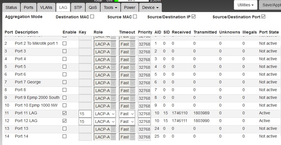

Two days ago it quit working and nothing was changed. The counters on the LAG tab for these two ports quit incrementing. Everything is set for LACP-A like all other towersites and exact configurations. We have rebooted the mikortik and it still will not show load balancing across the two LACP ports. IT just shows traffic on one or the other port but not both. if we shut down a port on the mikrotik it forces traffic to the other port and visa versa. The only thing we have not tried is rebooting the Netonix switch to see if that clears the issue but we wanted to check here for any other cause or something we need to look at.

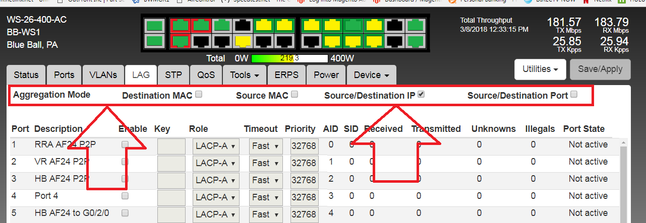

Second notice the settings at the top of LACP
If you select source or destination MAC you might get all traffic on one port if all the traffic is routed traffic because the source and destination MAC would remain the same.
You only use MAC the defining balance on a Layer 2 FLAT SEGMENT.
If you have a router hooked to the switch and the traffic is routed then you need to use source and or destination IP as the criteria to load balance.

But the fact it has been working fine until 2 days ago and is still working on 12 other sites exactly the same way is baffling? Did you look at the attachment on our current setting?

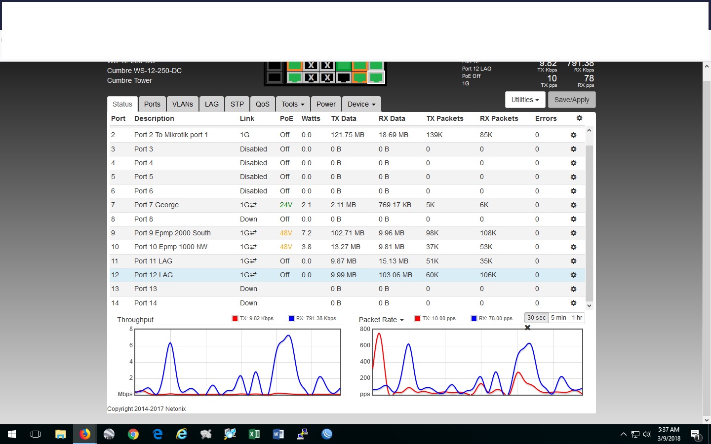

Also show me a screen grab of Status TAB with a graph for each port in LAG

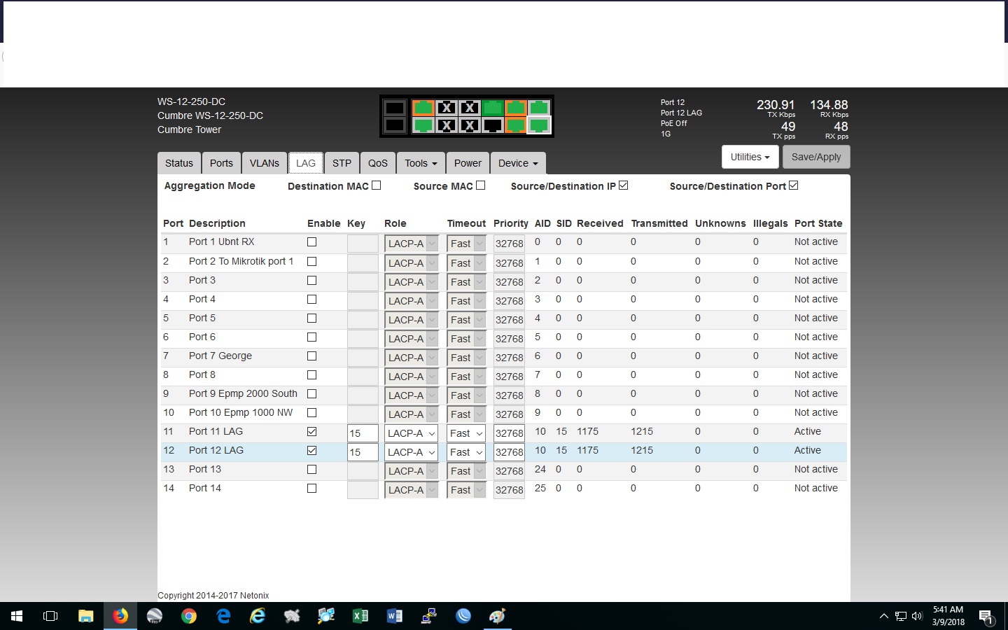

Re: LAG not working properly anymore
Here is what I think you were asking for. I didn't see this post until after I rebooted the unit in question..

If under the LAG TAB both ports showed active for the LAG then the switch should have been divvying up the traffic going to the router across both ports. Keep in mind the traffic is never symmetrical as it does so on a per stream not per packet basis.
