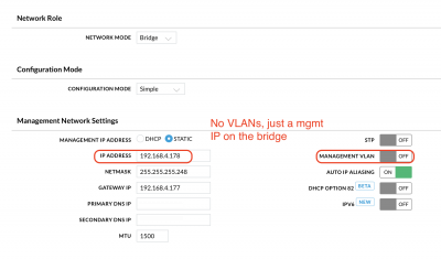

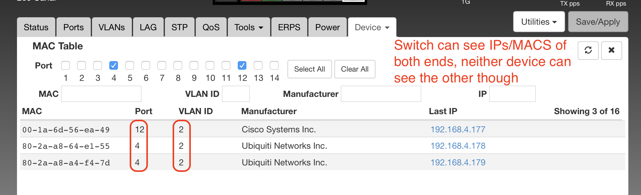

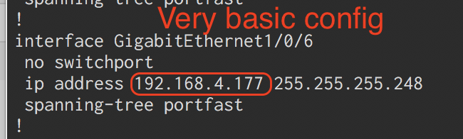

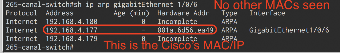

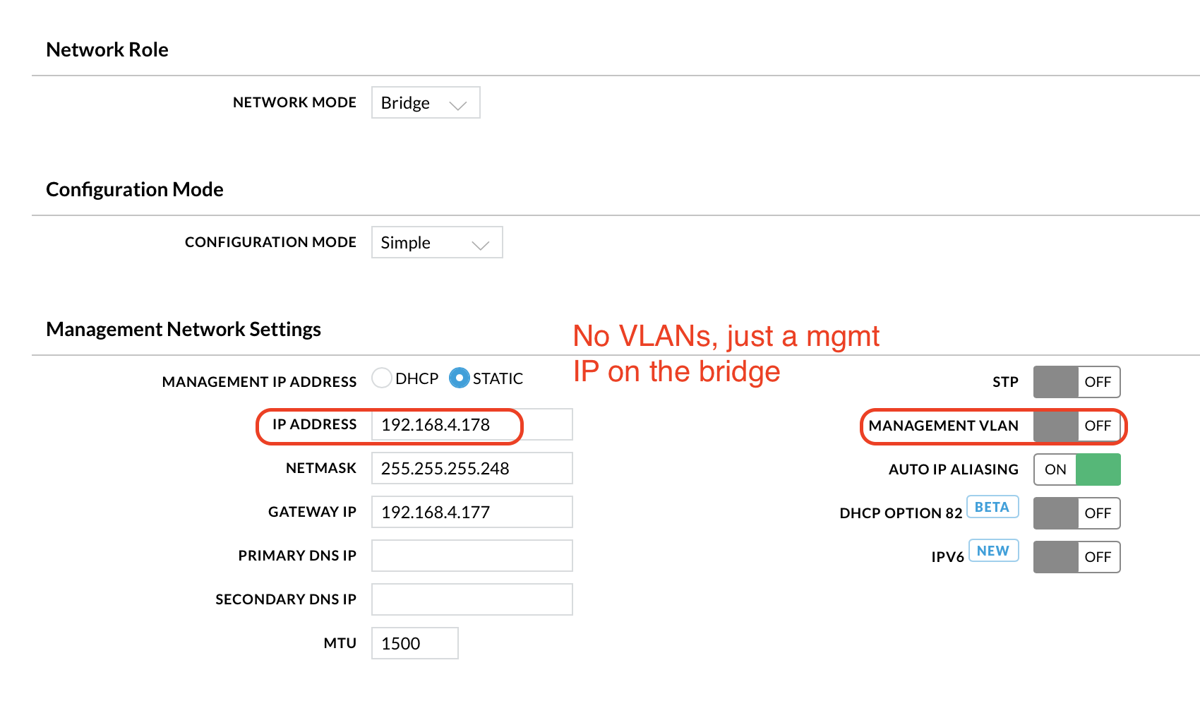

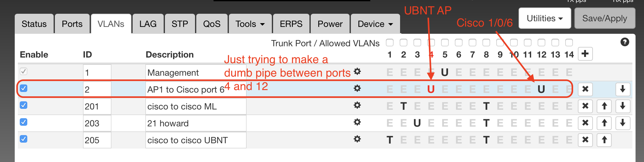

Not really having any luck with this. I'm basically kind of trying to turn the Netonix into not much more than a managed mid-span POE injector.
I tried the "pick a VLAN ID, and then put the ports i want to tie together into that VLAN" method, both with "U" and "Q" and no matter what I did, traffic was not making it through the Netonix. One one side, a UBNT AP at 192.168.4.178, port 4 of Netonix (and a CPE bridged beyond that as well @ 192.168.4.179). On the other side a port on a Cisco 3750 configured first as a switchport in a VLAN with the IP 192.168.4.177 (mode switchport, switchport access vlan xxx) and then as a routed interface, also with that IP, just to make the config as simple as possible.
To be clear, neither device, the cisco nor the ubiquiti were configured with any trunking. Just a device with an IP and no tags.
Some pics below, perhaps that will explain this better:
This should be easy, but I'm at a loss here. Am I totally not getting how port-based vlans work on these units?

I use midspan just like your going here and it works great for me. In fact EVERY switch/tower I have relies on midspans for every backhaul.
You can see my config here: viewtopic.php?f=30&t=452#p2961
And you can see it live in the video I posted: https://www.youtube.com/watch?v=8JvBEAD4MFM
If your using U and U then you can only pass Untagged packets.
If you use Q and Q you can pass both Untagged and Tagged but never tried it as I do not run VLANs between towers.

The config seem fine. If you plug the ubnt AP, via PoE brick, directly to the Cisco, can those communicate togheter ? Have you try to set an IP address on the netonix VLAN to check if the Netonix can ping any of the devices ? To add an IP address, click on the gear between the vlan description and VLAN config by port.

Hmmm. So I am doing it right then - and in this case (not using any trunks) it should work with either "Q" or "U". And the VLAN ID in this use case is really just anything I want, right, it just has to be something that's unique.
In the "working" case, I can tell you that putting setting this so that the UBNT AP remains "U", AND a trunk port back to the cisco is set to "T", AND the VLAN on the cisco is moved from the access port and to an "allowed vlan" on the trunk port, communications is A-OK. That is the current, working setup. Not sure what that tells you other than to confirm that the UBNT is untagged.
Are there any other settings that I might be missing here? Should I need to fiddle with disabling RSTP on these ports? Anything else? I'm on 1.4.9.
