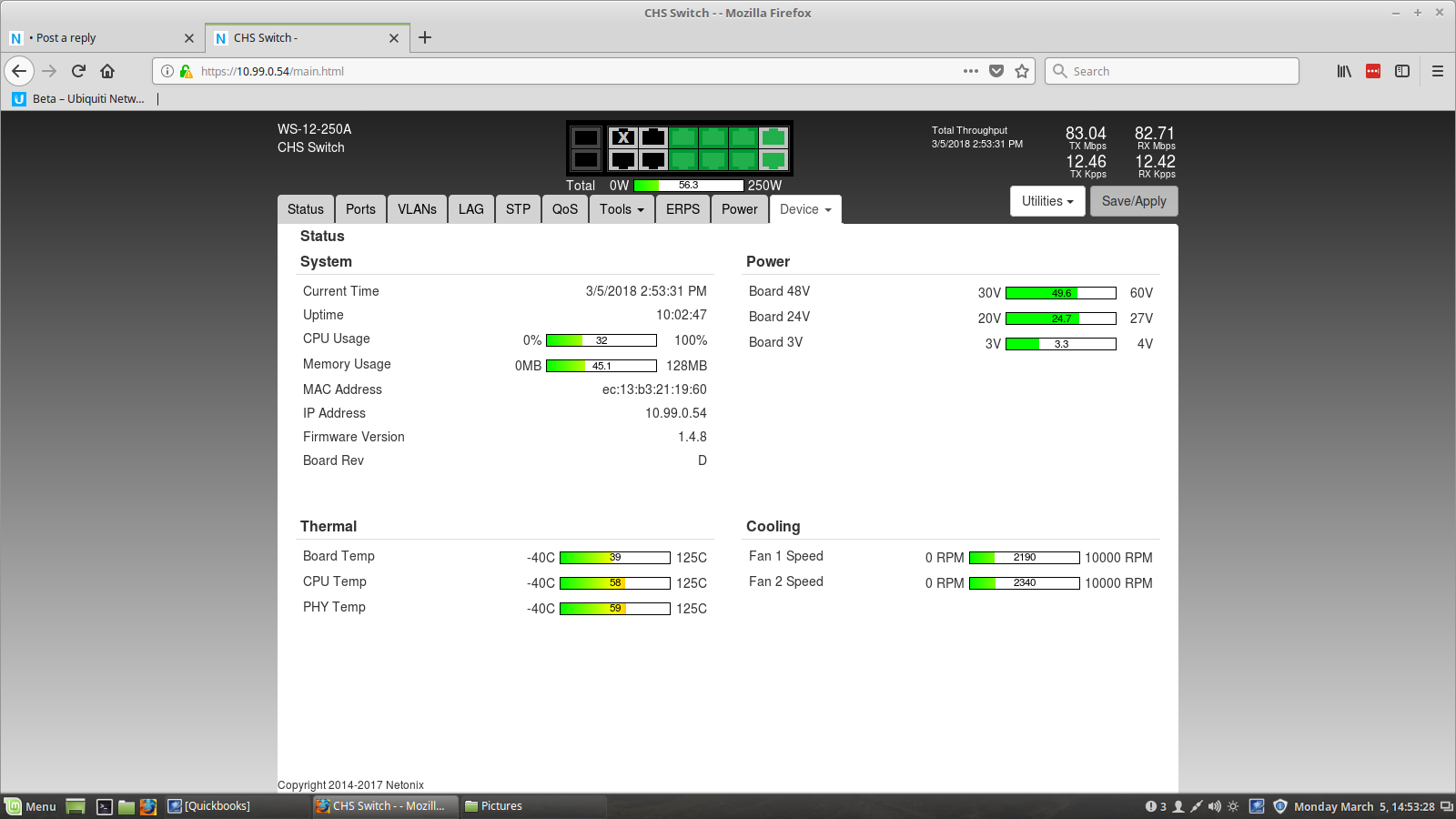

Re: WISP switch rebooting
Posted: Mon Mar 05, 2018 4:08 pm
No a WS-12-250A is not a SMART DC unit, it is an older AC model.
So I take it this unit has been in service for awhile.
So please post up a screen grab of the Status and Device/Status TABs (see my post signature on instructions to do so)
So how is this unit powered, is it plugged into a UPS, and if so what model?
It is possible the UPS is going bad?
It is also possible the unit is damaged?
It is also possible the power supply is failing? <== Doubt this to be the case
Even though it is beyond the Warranty period we still do repair them so you can RMA it but I would make sure this is not a UPS or AC power blip causing this first.
Posted: Mon Mar 05, 2018 5:54 pm
by mblfone
Status screenshot
