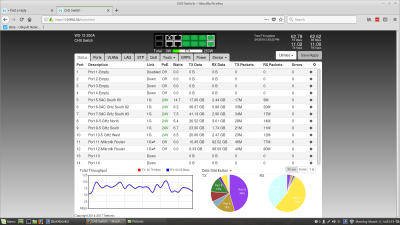

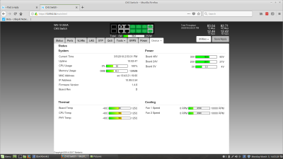

So please post up a screen grab of the Status and Device/Status TABs (see my post signature on instructions to do so)
Status screenshot

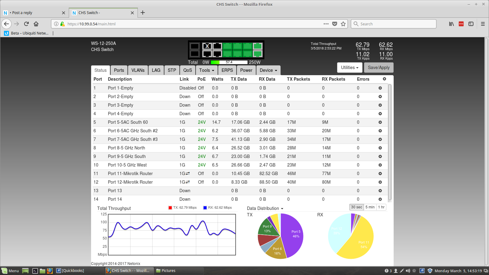

Status/port screenshot
