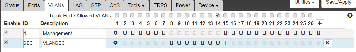

I have a strange issue where when I move a certain port into a VLAN it will actually move a different port into the VLAN. I have upgraded to the latest firmware thinking that would fix it because the first thing in the changelog is a VLAN fix but it did not. Is this a known issue or am I missing something? Also I have verified that none of my ports are mislabeled.

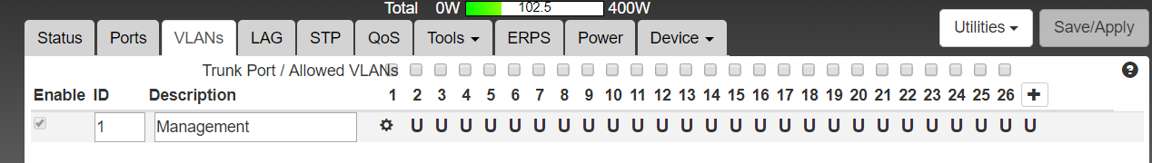

Maybe put up a couple screen grabs to demonstrate what your talking about.
Re: VLAN Problems
jakestevens19 wrote:Basically I will add port 8 to a VLAN and the device on port 7 will lose connectivity to the network.
Please post up a screen grab of the VLAN TAB before you make the change and after the change.

So I made port 14 a trunk port and it made port 15 Tagged traffic on VLAN 200 and will not allow me to change it from that setting

Are you noticing that the column header for this model (26 ports) appears messed up.
You have the browser zoom above 110% - UN ZOOM

I figured it must be something like that. So 6 is 2, 7 is 3, 8 is 4, etc? Is there a way to fix this? I upgraded to the newest firmware hoping that would fix it.
Re: VLAN Problems
Actually it is not a BUG you have the ZOOM on your browser set above 110%
UN ZOOM to 110% or better yet 100%
Make sure your column headers are lined up with correct column.
When you zoom too large it messes up.

I see. I actually had to zoom out to 80% to get them to align properly.
Re: VLAN Problems
jakestevens19 wrote:I see. I actually had to zoom out to 80% to get them to align properly.
What browser are you using?
I use Chrome and it lines up to 110% zoom

I'm using chrome but this laptop has a pretty large screen. I guess that solves that issue though if I just go to 80%.
