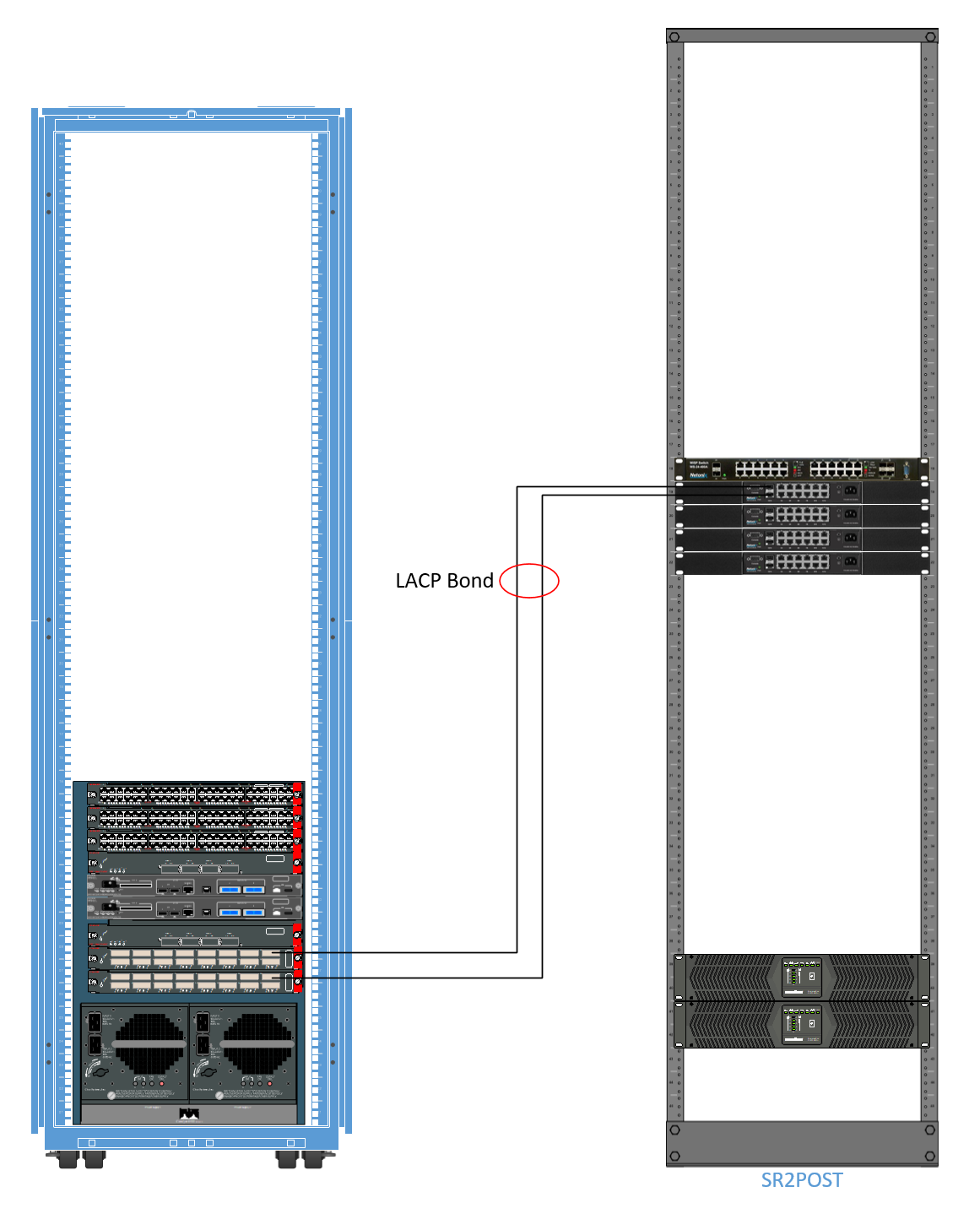

I have attached a quick drawing of how the two devices are connected. All 5 Netonix switches are connected in the same way. SFP13 connects to a port on Module 8, and SFP14 connects to a port on Module 9. This issue is only impacting this one switch in the stack.

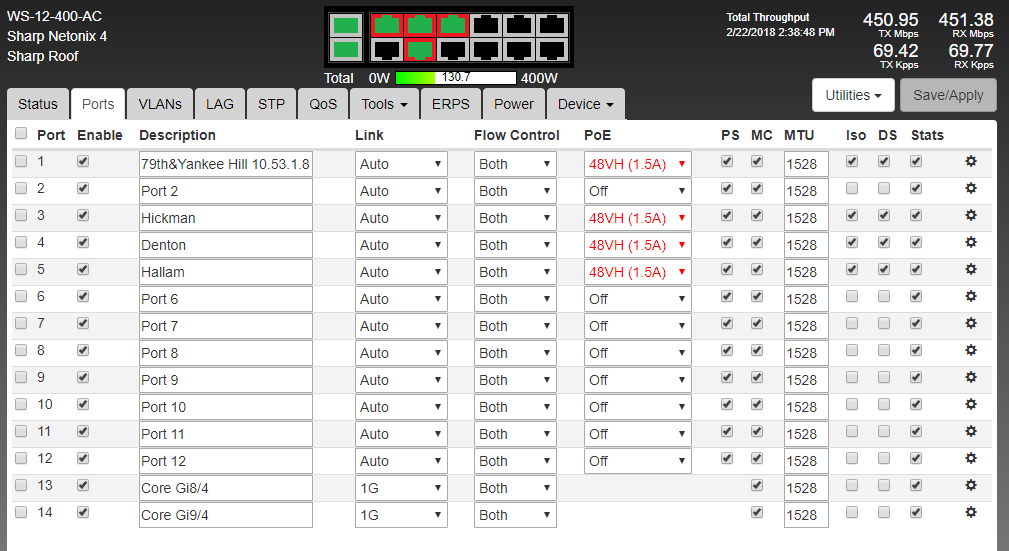

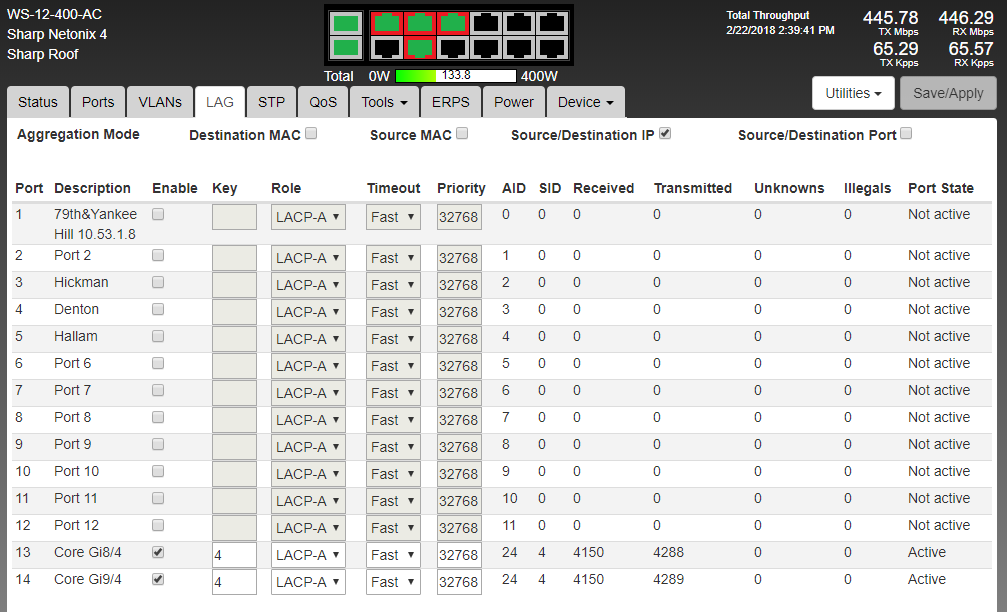

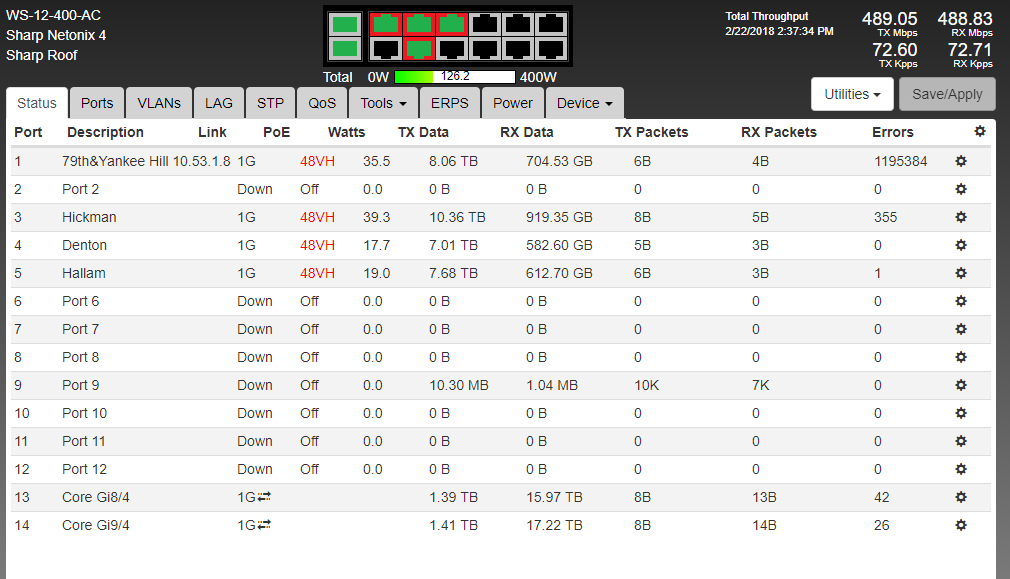

I've also attached a screen shots of the Status, Ports, and LAG tabs in the Netonix.
