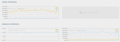

So this morning I did a backhaul upgrade. Switched from the old UBNT 5gac BH to a Metrolinq ML2.5-60. I was nervous about using 60GHz so I wanted to leave the old 5gac BH in place as a failover. I hadn't done RSTP in the past, but needed to for both BH's to run at the same time. I'll paste the RSTP config page below. Everything worked fine before the upgrade, and it seemed to work fine after as well. It wasn't until about 4 hours after the switchover that I started seeing extremely high throughput on the switch looking at "total throughput". It was showing 500-700mb throughput. I checked the new BH and it was pushing about 120mb. Everything feeds through this new BH so I'm not sure where the extra 500mb is coming from or going to. What else do you want to know? Is this affecting my available throughput on the switch or is it a bug?

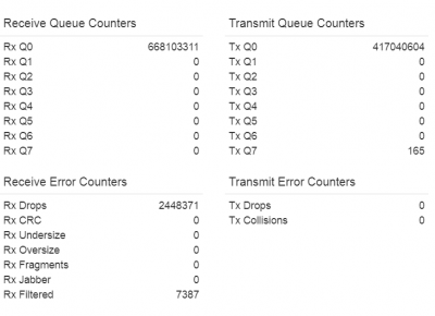

Another possibility is a TON of pause Frames from Flow Control. Check the stats on each Ethernet port (Click little gears on Main Status TAB) for excessive Pause Frames.

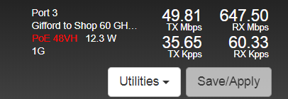

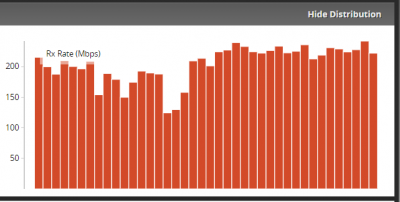

I understand that the total means total, one readout for total Rx and one for total Tx. I get that. So here's a pic of that port's traffic from what the Netonix says, and another pic from what the BH connected to that ports says. The Netonix says over 600mb is running through that port, but that BH that's connected to it shows about 250mb on average. So my question, again, was, Where is that extra 350mb being generated from? It's not running over the BH.
There are no Pause Frame errors. There are Receive errors. I've attached a pic.

Compare the graph of the switch port to your radio to the throughput of the radio.
Why are you looking at the total throughput graph?
Like I said look at the graph for each port and see what other traffic between other ports may be going on contributing to the total throughput graph.
When you select the port line on the Status TAB you see a graph for that port, compare it to the radio graph on that port.

Did you even look at the pictures??? Go back and look at all those pictures I posted. The second set of them. You can clearly see it says PORT 3, with a Rx of 647.50mb of traffic. The OTHER pic shows the traffic graph on the BH that corresponds to the PORT3 that it's plugged into on the Netonix switch.

So the Netonix shows 647.50mb of traffic ON PORT 3(this is the port the backhaul is on), the Backhaul shows around 200mb and the core router shows around 200mb.
Something is wrong. You say that the Netonix can't possibly be wrong. On the same token, it can't be both the core router AND the backhaul being wrong.
