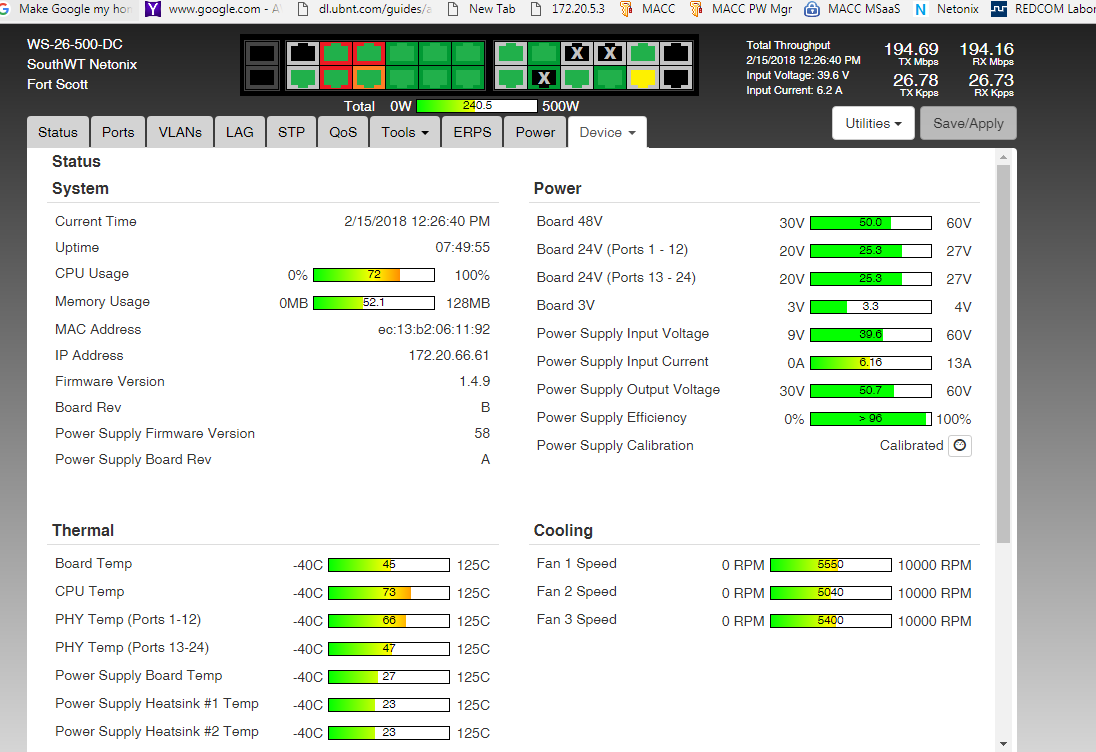

Re: WS-26-500-DC intermittent power issues??
David Lee,
Can you please post up a screen grab of the Device/Status TAB
Good afternoon Chris-
There are two devices in question. Both are having the same issue (powering off/on repeatedly). The devices are on separate towers in different systems.

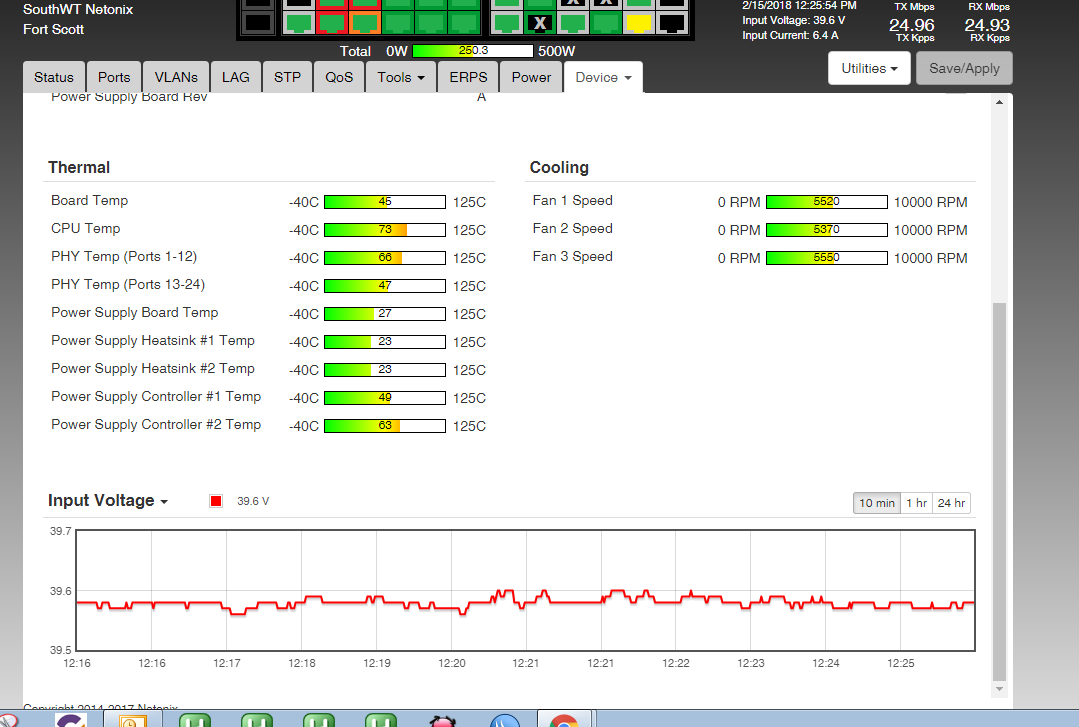

The ifirst device has already been taken out of service and replaced with another one. This one was upgraded to 1.4.9 from 1.4.8. Even after the upgrade we still had issues thus we pulled it. I'm hoping to RMA this one so that I can determine problem
The second device is still being utilized. We upgraded it from 1.4.8 to 1.4.9 early this morning. 8 1/2 hours later we've not experience a drop. I have included the requested Status screen shot of this one.
david
I was wanting to look at the 48V voltage which is correct at 50V.
Should be 50V if all is good but if it shows 53V that "can" mean one of the 250W sides in the 500W is damaged.
So that looks good....
Please post up the Power TAB
