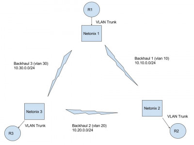

I'm trying to figure out how best to figure out where a loop is coming from on my network. See attached diagram
All routers are mikrotiks running 6.36.4 and netonix are WS-12-250-DC and running 1.4.8 (or newer). Each of the backhaul links are on a separate networks and we route using ospf.
If I turn both radios on BH1 (have connection, OSPF sees adjacency), then BH3 goes down. The netonix sense a loop and block the port.
Sep 7 04:05:03 STP: MSTI0: New root on port 4, root path cost is 80000
Sep 7 04:05:03 STP: set port 2 to discarding
I'm pretty sure that this is NOT a netonix issue (well maybe a config issue on my side). How would I go about troubleshooting this?

Vlans and ports config would help. Maybe print screen or just the "show vlans" command via CLI and indicate which ports are use on each switch for those 3 links.
Re: Finding Loops/ STP
STP (and RSTP) is not vlan aware.
MST can be set up with separate instances for the vlans you use. If you only use the vlan for one link (besides the trunk to the router), you could simply disable spanning-tree for the interface to the link (both ends for each vlan/link).
Not VLAN aware but still protect again loop by blocking a whole port in the ring so loop shouldn't happen. He should get RSTP right first before adding more complexity with MSTP instances.
