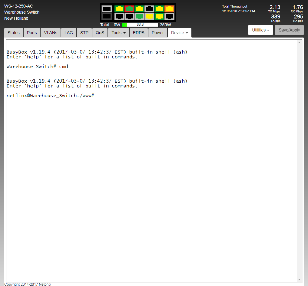

So I think your asking to be able to ping from the switch and set the ping packet size sent by the switch?
Why not go to the Device/Console
Type in "cmd" and press [Enter] and drop to Linux shell then use the Linux Ping command?
Then when finished type in "EXIT" and press [Enter] to return to our console, "exit" and [Enter] again close console connection in web UI.

sirhc wrote:So I think your asking to be able to ping from the switch and set the ping packet size sent by the switch?
Yes, that is what I am asking, but also to set "Do Not Fragment".
Thank you for the details above, but the built-in tool does not appear to have a do-not-fragment option.

Re: Feature Request: MTU and Do Not Fragment Ping Option in
It's busybox ping that don't cover all option of the ping utility. A simple exemple is that busybox ping don't support interval. What would need to be done is remove ping from busybox and add the true ping-utils from unix. I use to do that on my OpenWRT custom image since I use interval a lot to test link.
