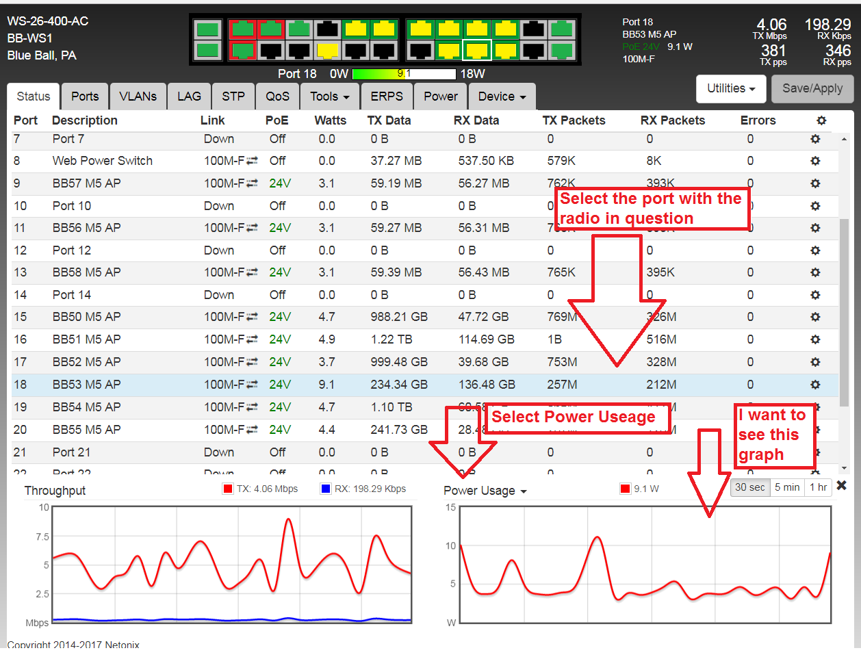

Put up screen grabs of the following TABs
Status - have the power graph selected on the bottom showing power consumption on the port your talking about.
Device/Status
Device/Status

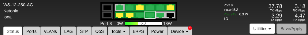

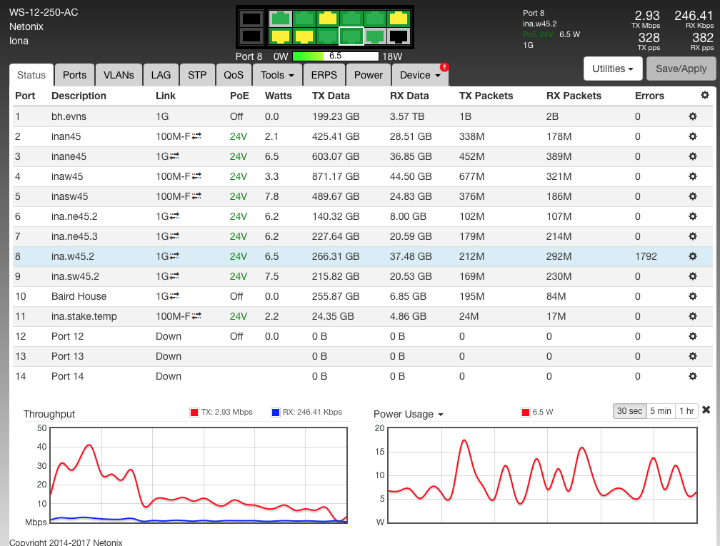

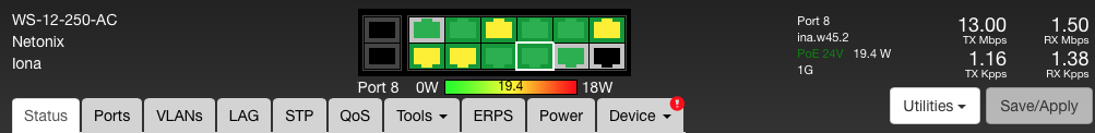

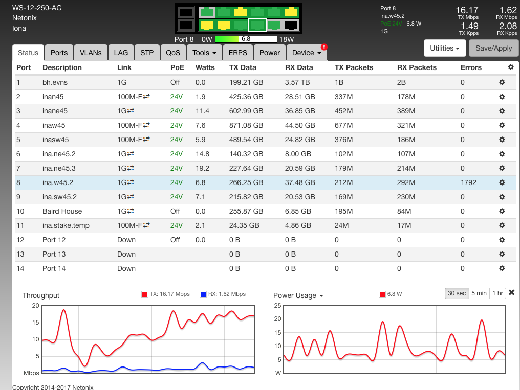

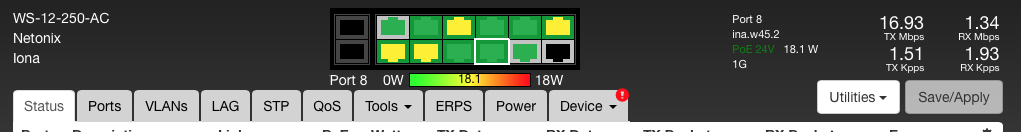

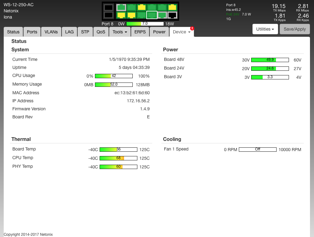

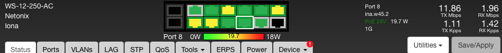

I am attaching a few screen shots, I just watched it for a couple min here, but as of right now the max is 19.7, as you can see its not passing a ton of traffic at that wattage and i have one where its sending 30 some mbs and the wattage is normal.

sirhc wrote:Put up screen grabs of the following TABs
Device/Status
When I asked for the Status TAB and display the Power Usage Graph this is what I wanted to see
Note: that I placed the image in line after I uploaded and then added the text above about clicking on it.
