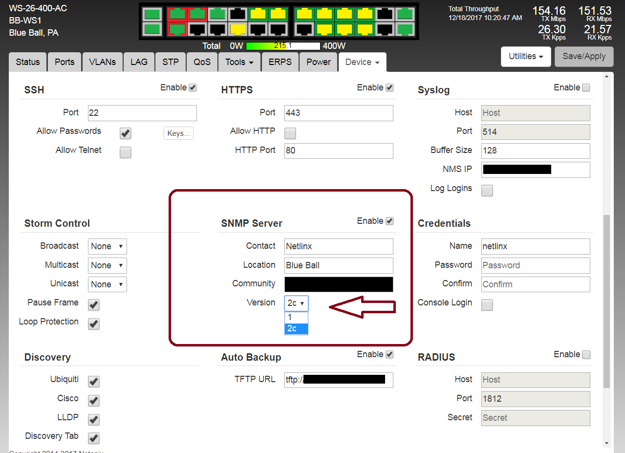

Hello, I noticed in recent firmware versions when I select SNMP version 1, the switch only supports version 1 and not 2c. Previously when selecting version 1, the switch would work with version 1 and 2c. We need both versions in our environment. The reason is that our monitoring system only scans version 1 (due to Ubiquiti devices only supporting version 1), then assigns profiles based on the sysObjectID value. We've historically had version 2c profiles for Netonix and Mikrotik equipment, but Netonix SNMP has stopped working in one of the more recent firmware versions. We really need the 64 bit counters version 2c offers. Would you please bring both versions back? It could be another drop-down version option such as 1/2c or like it was in the past where version 1 assumed 2c as well.

Re: SNMP v1 and 2c
I think he would like to be able to use both v1 and v2c at the same time, not only one or other.

Re: SNMP v1 and 2c
mike99 wrote:I think he would like to be able to use both v1 and v2c at the same time, not only one or other.
Correct, I need both. Each works individually.
