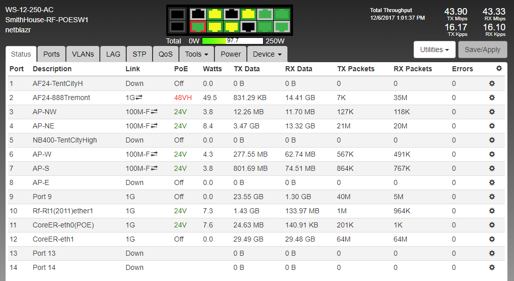

In the early hours of this morning (during rain), a two-year old but now damaged cable caused the PoE power to an AirFiber 24 radio to short out. This knocked out the WS-12-250AC switch that powered that AF24, and both of the site's routers, causing the site to go down. Port 1 of this switch is likely fried, but once a tech got there, identified and then unplugged the shorted cable, he was able to reboot the switch and the rest of the site came right back up. We've scheduled more permanent repairs for Friday.

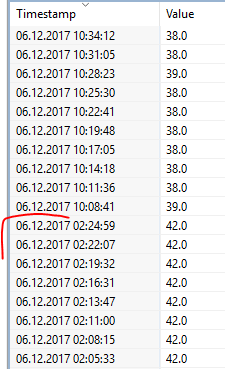

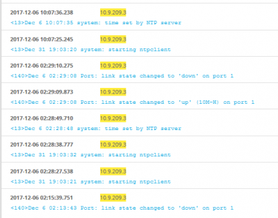

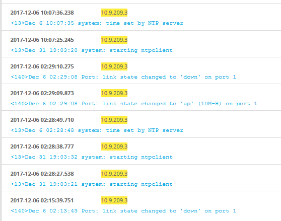

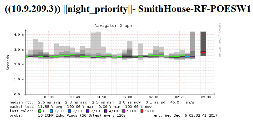

The switch is board Rev F running 1.4.7 firmware. What data I have is attached below. It appears port 1 went down at 2:13am, the switch went down at 2:24am, recovered briefly around 2:28am and then went down permanently at 2:29am.
I'm assuming the power supply shut down or went into current limiting as a result of the short. Does this make sense?
